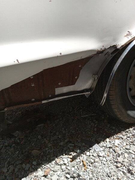

No sir. Bondo over wire mesh and backed with fiberglass is NOT a good job for quarter panel repair.
Nothing you did is preservation. What you did was make a shoddy repair that will take more time, money, effort and skill to fix than what was there already. If you can’t fix it right, you could have just wire wheeled all the rust off, painted the area with POR15 and moved on. The rust would have been stopped, the damage was cosmetic, and then someone with the skill to do it right wouldn’t have had to deal with the shoddy repair you did.

I’m afraid you just don’t understand. There is no such thing as a “quality” fiberglass repair on a steel bodied car. It doesn’t exist. You, or the next owner will have to undo, and redo that work at some point. And the damage to the original bodywork will be worse than when you started. You didn’t preserve anything.
