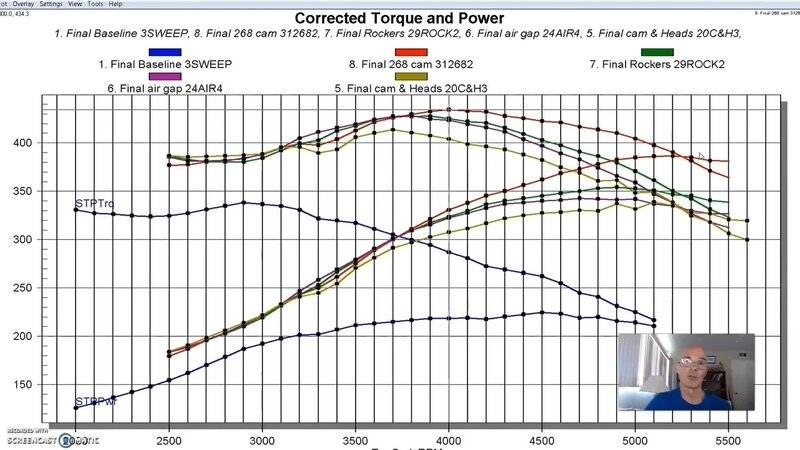

AFR MOPAR 340 HEAD TEST!
Dulcich must have the software version from the old mag dyno mill at westech :)
The jump in output makes sense to me.
Another point of compression from the smaller chamber with quench, better flow characteristics.
Starting from scratch, no rusty boogers in your futrure. Pick your approach.
What is a mag dyno mill?
Probably something like this xe268h cammed X headed (not ported) 340 392 hp 412 TQ , can't find a ported one yet.

For the budget minded guy, seems to me it would be a more viable way to go by selling a ready to run kit using the speedmaster heads. The performance seems likely to be extremely similar, and the cost would be significantly less.
10-20 more degrees and 0.050"-0.100" more lift would really wake that 340 up, I feel a lot are glossing over how small of a cam their running.
You are correct. Not everyone needs the extra though. 440 lb ft and 440 hp from a docile 340 street engine is damn near a perfect combo for street driven car.
just under $2000 for the AFR heads, I also wonder how the test would have compared to a decent pair of 2.02 X heads. The 360 head had 1.88 intake valves
For reference Dulcich build a stock bottom end 340 with X heads that made 400hp with the same cam about 20 years ago. Magazine article for Mopar Muscle if I remember right.
You could spend 2k on sh#t for your car that makes 0 hp, I don't really get the argument, it's a pointless argument and has near zero to do with the thread.
2,000 / 65 = $31 a hp
Say you got a mild 350hp 360 now you want 200 hp increase to 550 hp 408 and only the block is being reused, plus your gonna upgrade tranny rear end brakes tires and rims exhaust etc... to handle/work with it, is $20k+ for 200 more hp worth it ? $100+ a hp ?
100%, To me that's the big take away, a 440 hp under 6000 rpm 340 with an xe268h cam.
