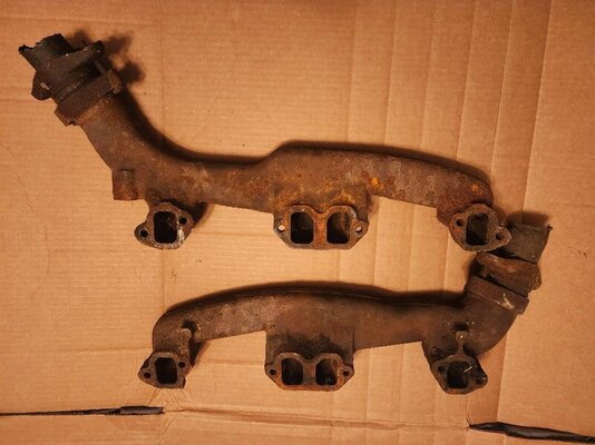

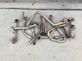

First was a 1971 dart swinger when i was 16 35 years later I just picked up a 1967 dart with a 360 and 727 I cut off old headers want to go back to manifold cant figure out what set will work both fit passenger side. Thanks for any help or idea's
First set
looks like the 1st set due to the steering box and look correct (driverside has tabs /ears for the hot air stove pipe)
most likely be able to get a desent stock exhaust system or a good shop to bend pipes.
Second stocks like magnum truck. I believe they have the biggest outlet. But the upswept drivers side says Mopar.
None of the modern rear exit manifolds without the "uey" bump will fit the driver side. So 3rd, 4th, or last photos the pass side may be workable, the driver side will not
So the top ones wont work then either i guess im on the hunt for a set. Will either one of these work for me.
After reseaching I beleive I need 3614368 or 2863553 for driver side and 3418623 or 2863549 passenger. Does anybody know if there is any other numbers that will work? I don't have ability to pull motor out so can i fit in any shorty headers easily?
In post #7, the top pic is the same style 318 manifolds as your original pics. The second set in post 7 are B,C,E body small block manifolds. The passenger side will work in an A body, but the drivers side won't. What would work the best are a pair of 72 and up 340/360 exhaust manifolds. Sorry I don't have the numbers.
