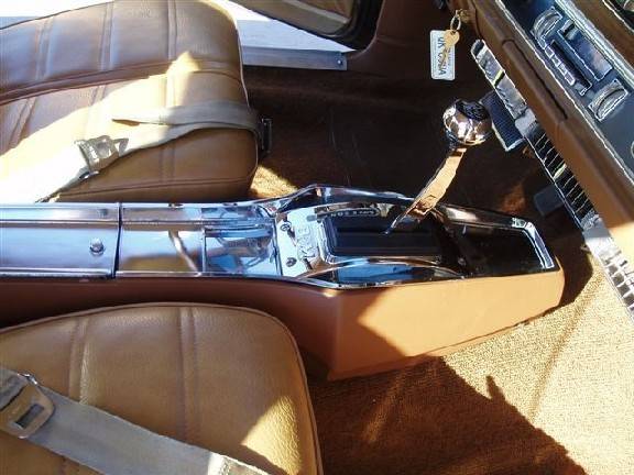

Here is my take on a B&M Quicksilver in a factory console. I actually moved the console back a few inches and raised the shifter off the floor so it would be in a more comfortable position to reach. I run the Lokar kickdown with no interference issues, but it is close.

I know this is a few months old...but this is the one I plan on using in mine. Luckily someone else has already cut up the the top plate so I won’t feel like crap when I have to cut it to make it work!!!
Niiice. What factory shifter pieces were modified and used for that install? What body type is it mounted in? I suspect E body. Floor in backround doesnt look like an A body
