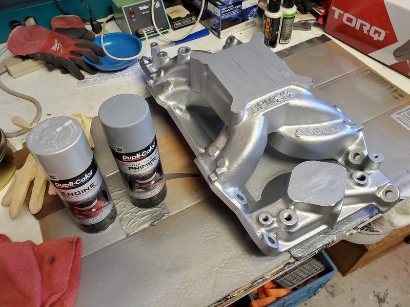

For those who painted.. did you primer first or shoot directly to bare metal?
I cleaned the manifold with a degreaser ( Varsol) . Then I cleaned it again with thinners. Primed with a grey primer then used the Duplicolor Metallic . 4 years and 7000 miles later and it still looks great!
