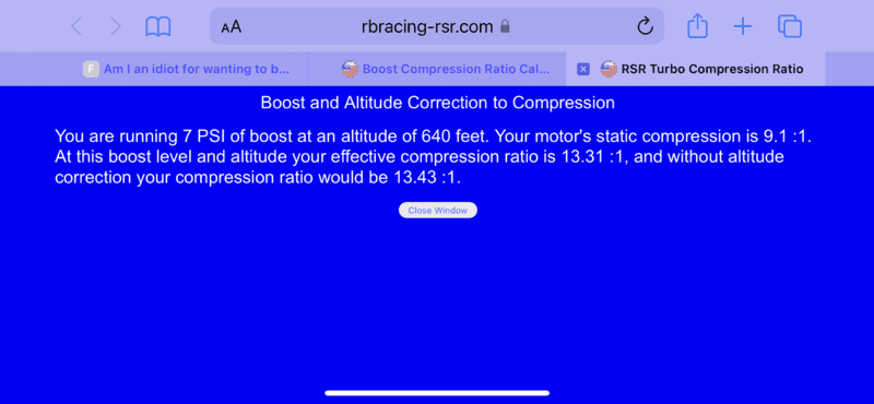

4 pounds of boost at 10.3 static compression work out to 13.1 cr at sea level at 5000 feet is about 1 point less (12.1)
Do you have a link to the calculator for that? I’ve heard an old general rule of thumb was every 4 pounds of boost is equal to one point in compression but always thought that was “out to lunch”.
Just thought it was worth pointing out. My daily driver is an 8.1 BBC in a 3500 dually with a remote mount garret gt55. I run 7 pound springs in the gate. It has over 560k miles on it. And using the link above, this is what I got.

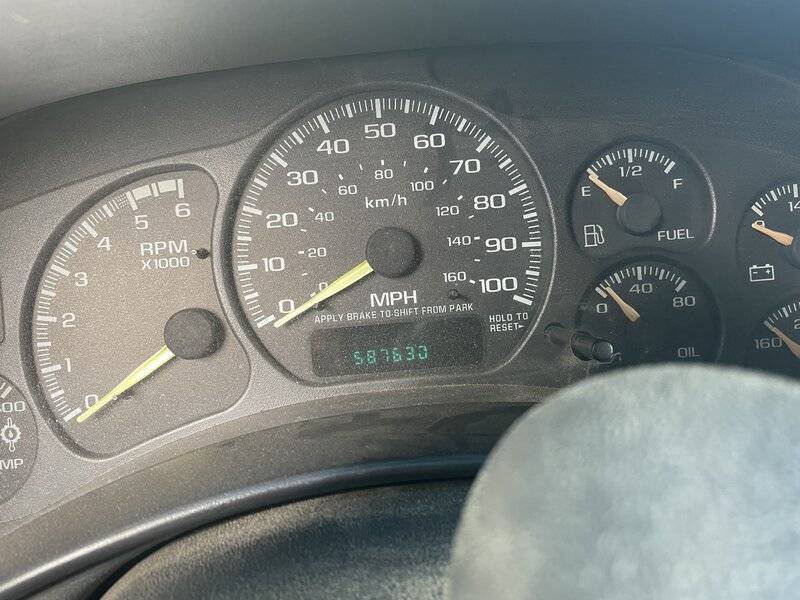

You have over a half million miles on your bbc and it's NEVER been apart, that's very rare.
Owned since new. At 160k miles I tore it down to gap the rings and put a cam in it. Went back together with all the same original parts. The only thing I changed was the ring gap and the cam. Then built the remote mount turbo set up, and put a set of 100lb injectors in it. It’s been the best vehicle I’ve ever owned.

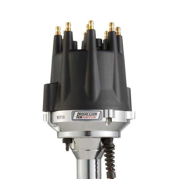

Electronic engine control and careful tuning is the key. Holley Sniper would be good for fuel management. Now spark control is a ticklish point here. Setting up a conventional distributor would be difficult. I believe the company is Precision Distributors. They sell a programable distributor that you program using Blutooth from your phone. It has a MAP sensor in it to function as vaccum advance and also works on boosted engines for boost retard.
Progression Ignition
I looked them up and it sounds very intriguing. I might just go that route.

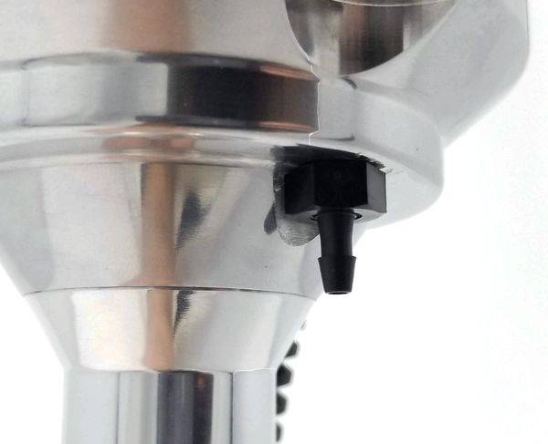

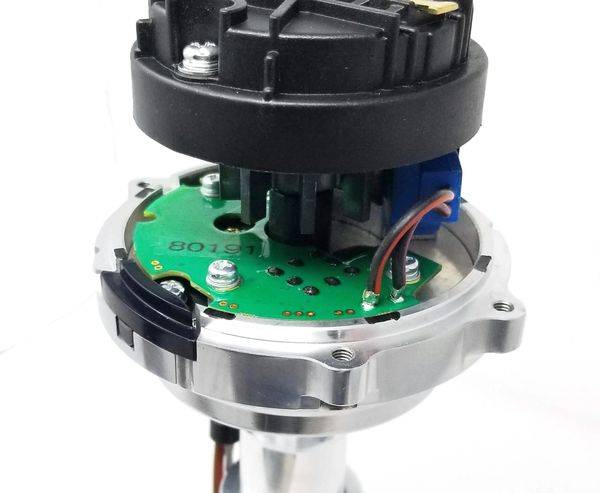

Chrysler
  • Ignition timing is adjusted with your smartphone or tablet using the Progression Ignition Tuner App. There are NO mechanical adjustments inside the distributor.
  • Easy to use! The app will create a custom timing table for you by entering just a few basic numbers.
  • Tune with a modern style timing table interface. Powerful editing features for expert tuners but easy enough for a novice
  • Make timing adjustments in real time with the engine running or not
  • Store as many tables as you want on the smartphone or tablet. Change tables instantly using the app.
  • Theft prevention feature prevents the engine from starting using the app.
  • Wireless Bluetooth connection
  • The internal ignition module maximizes coil current to 8 amps up to 10,000 RPM
  • Built in Rev Limiter
  • 2.5 bar MAP sensor for turbo and supercharged applications
  • Timing range of 10 degrees BTDC to 50 degrees BTDC
  • Separate tachometer output wire
  • Sealed upper ball bearing for the shaft
  • Diameter of distributor is 4 1/8” not including the mounting lugs.
