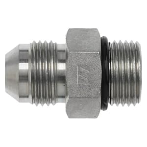

JIC X O ring boss

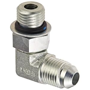

JIC (flare) X O ring boss 90 elbow
