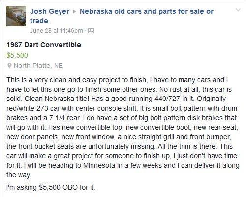

Not much time to write now but I came across this post on Facebook and felt it worthy to tell FABO members about.
Nice car, I really think you should get that John! Maybe take some of the sting out of the funny car loss.
Nice thought Scott but recent losses have made any new project funds non-existent. If things get any tighter around here I'll have to start selling parts to afford toilet paper.
That drop-top looks tempting, but why the fresh paint, and show pics of a used fender?
That confused me too. I'm guessing he's dumping any of his extra Dart parts along with the car. Maybe it was one of the original fenders off the car.
I was watching that car on evilbay. Hope you get caught up with your funds. I like reading your adventures.
Thanks jaws. I didn't realize that Dart had been posted on eBay. My Facebook account is mainly comprised of car buddies and car related groups. That's where I found it. Did it get any bids on eBay? It's always seemed to me that selling a car located in the middle of the country where the population is sparse tends to draw less bidding than the ones closer to the big cities.
