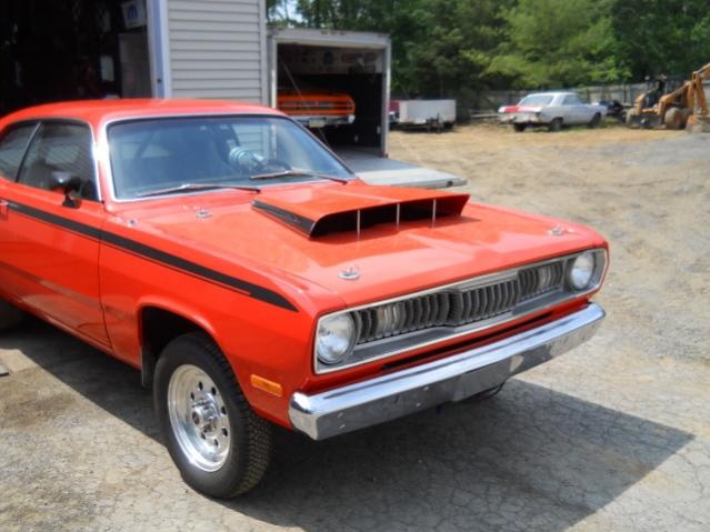

Does anyone know this car or what magazine it was featured in. I never saw such shitty work in my life. It is ashame for this car. But it is going to be taken apart. Who ever built it should hide their head in disgust.
Coming here was probably the best thing that could happen. Oh yeah I grabbed a shot of mine sleeping.
Note the spring hangers are welded under the rails and then blocks were added to lower the car.

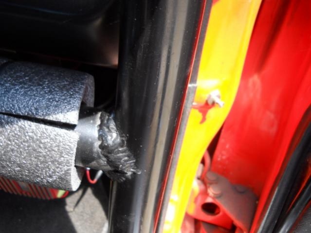

All welds are as good as the ones pictured on the cage.

There is alot of good parts just not applied correctly
Two motors one B-1 the other angle plug eddies . Megablocks
Well does anyone know who's car this was? Or are you ashamed to say you know. I remember it in a Magazine but I don't remember which one.
I would like to send them some pics of it coming apart to make their day.
How about the house door latch that holds the electronics board up under the dash. or the trans cooler mounted behind the front plate so you can see the AN fittings and lines when they are installed for show. Wait until you see the mess under the hood.
Hughes engines did both motors. They were both junk as they were not machined correctly and coil bound.
home made dual plate 3/16 elephant ears
Lokarr (Universal fit all). ready to rip throttle cable.
No money spared on parts . Just no quality on doing the work.

I had to look hard at the weld it looked like carpet coming out of the tube. You'll get'er whipped into shape, as you do amazing work!

That is one of the better welds. The wires pictured are under the glove box . That assembly is hinged and locks up out of sight using that door latch.
