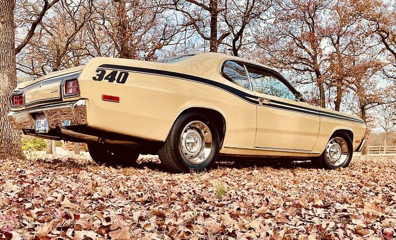

1972 Duster. 275-60-15 on 15x8 w/4.5 works perfect. I'm all stock, no cutting, no spring relocation or SS springs and no air shocks. Fit perfectly and don't rub, even hitting train tracks at the 30mph.

Something about that car isn’t stock, because that ride height is not factory.

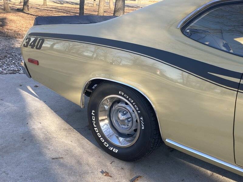

So I end up going with the 245 60 15...thanks TT30. ,,and go-fish for all your help.. They fit great.They look great.No rubs no issues .. No Longer.

So I end up going with the 245 60 15...thanks TT30... They fit great.They look great.No rubs no issues .. No Longer.
