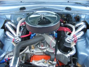

My 65 Barracuda had fenderwell headers with previous owner. He ran over a parking stall divider block and destroyed the headers so went manifolds, which severely choked the side pipes before he sold it to me. I've been making my own headers.
those look nice. have you started on the drivers side? ive been working on my drivers side first, ill put up some pictures of what i have. im going a little different direction than the traditional direction.
