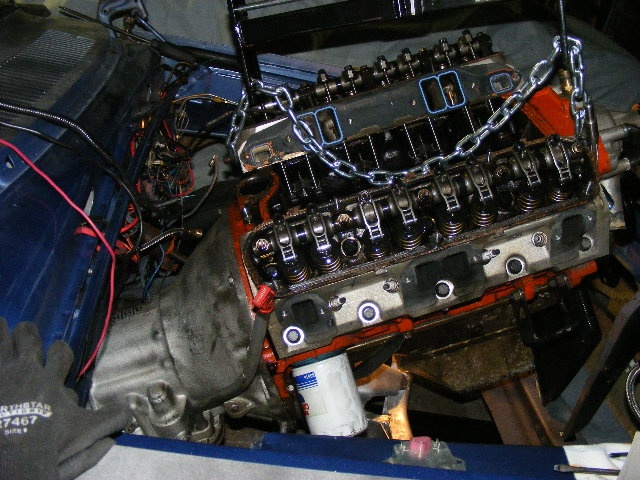

no way ,neither will i, especially with an aluminum intake. i always use a good old fashion chain and intake bolts in their respective corners. i yank and drop motors all the time this way by myself, by simply moving the car and raising or lowering the engine as i go. it really is easy.
