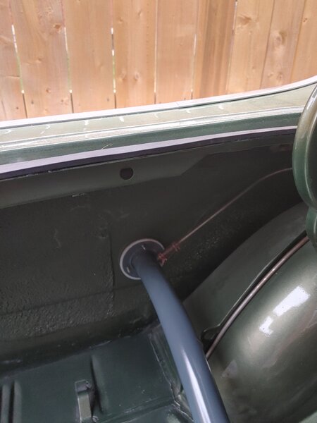

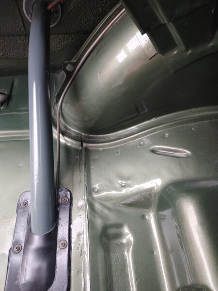

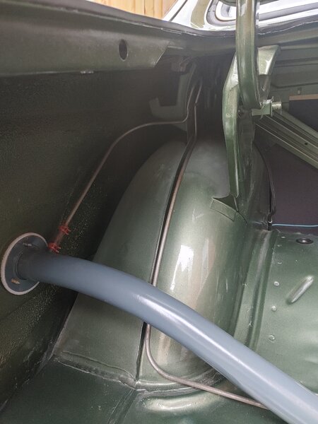

As promised. I don't have the clip that goes over the pinch weld on the wheel well installed yet in these pictures. At the top there is a clip similar to the ones that hold the fuel line under the car. You can kinda see it in the first picture
I just googled it and looks like the 66 is the same in all the pictures I can find unless it's a convertible
Thanks, that's exactly what I needed.
