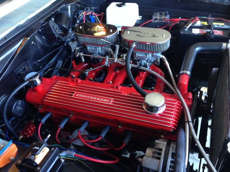

Maybe you should add a second one, something like this. :)

What I am actually battin around is two 32/36s. That way, I will have progressive carburetors and I can use progressive linkage. That would probably get pretty decent mileage while still being pretty snappy. This is comin from the guy that's fixin to pull off a 450 vacuum secondary four barrel and replace it with a 650 double pumper. lol

You're probably not wrong on that. I would love to have two carbs just for the cool factor, but with a limited budget, this being my only car and having an 80 mile round trip drive every day, it's not something I wanted to try right now. With the way I have my car set up, I average 25mpg driving relatively normal. 32mpg whenever I make the long highway drive to see my parents 2 hours away.

That would be a fun project for you to set up Dual Progressives on a Chrysler Slant 6.

Yup, that's kinda the idea. Along the same lines as the mileage and power of a Thermoquad. I would try a Thermoquad if I had a good one, as I have a spread bore adapter for the Offenhauser intake.

Someone used to build and sell the modified Offy 2x1 intake with the dual Webers back in 2002 when I got my Duster. Bad thing was it didn't work with the RV2 A/C compressor.
Clifford sells a dual Weber intake for the slant. Do not know if it would work with air or not. Probably not.
