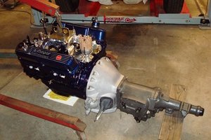

My new airgap

wildcat: that is a sweet lookin' motor you got there...
