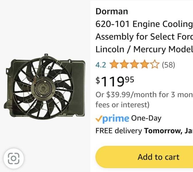

It’s just the OE dual electric fans from a 1995-2000 Ford Contour v6. Same fans and install information I posted above in post 14.
Tried and true, OE designed electric fans designed to last 100k miles plus. And yeah, $150 for a 2 speed, dual electric fan set up that flows ~3000 CFM on low speed, close to 5k CFM on high speed and fit well on a 26” radiator
I just contacted Dorman after seeing a negative review on YouTube from one of the Mustang guys, and the specs from Dorman tech Nicholas Paris are:
The Left side fan is 1007 cfm
The right is 1114cfm
They both draw 5.8amp each
Looks to be 1 amp rating

So it looks like I'm better off with junkyard parts, IF I can find some!

I reached out to Mr. Paris at Dorman again to confirm that he has looked at the correct model for the specs, since as 72bluNblu pointed out that both fans should have the same speed, and that each has a low and high, and this was his reply:
"That is what our drawing calls out,
Have a good weekend"
Go figure. I'll call the number in person, I think.

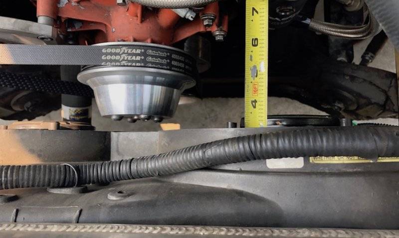

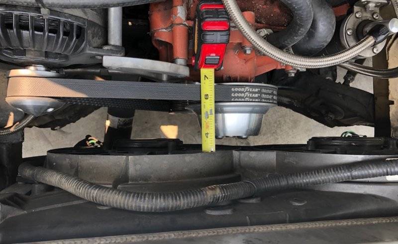

Those of you running the Dorman Contour fan/shroud setup (Summit RNB-620-104); what is the thickness of the assembly from mounting point on the radiator to the deepest point toward the engine?
It's about 3" from the radiator to the back of the shroud and about 3 1/2" from the radiator to the back of the motors. The motors are offset though so the spot with the least amount of clearance, the front of the water pump, is actually between the motors and in the section where the shroud is ~3" thick from the back of the core to the rear edge of the shroud.
