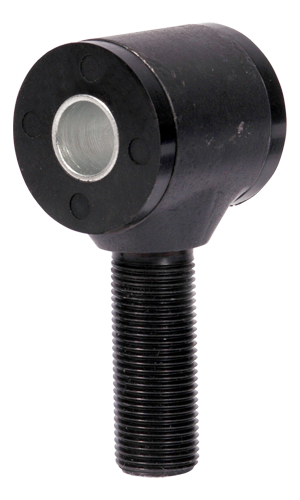

Get 2 right and 2 left hand of these from Rod End Supply
Then Go to http://pitstopusa.com/ and order 4 suspension tabs and 2 swedged tubes to fit your rod ends and make your own like Cal-Tracks. Don't need those fancy brackets and linkage. The rubber in the rod ends gives a little to let suspension move Weld the tabs to bottom of u bolt brackets and then extend the front spring mount down. Lots of people have done their own around here there are a lot of us Red-Necks

But with rubber rod ends to give some flex. Didn't notice til I posted picture but front mount needs to be directly below front spring eye to keep things parallel
