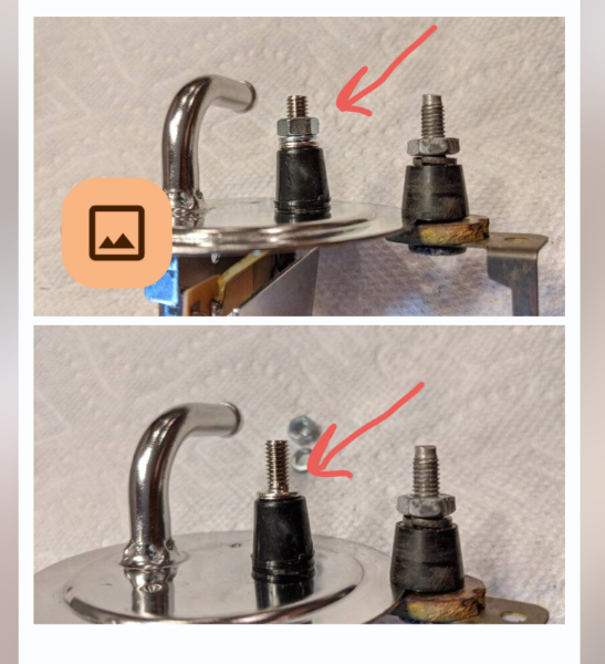

Sending unit is giving me a reading of 66 ohms. It’s a new sending unit. There’s about 4-5 gal in the tank. This reading was using my multi meter on the stud of the sending unit and the metal line that comes from upstream on the car. I applied ground briefly to the plug that goes on the sending unit stud using a power probe and the gauge in the cluster does rise as it should. With everything connected as it should, I added a supplemental ground with alligator leads from the metal line coming out of the sending unit to the metal line from the car. My gauge doesn’t budge off empty
I have a new solid state limiter in the cluster along with new circuit boards. I’m getting 5v at the plug when checking with my power probe.
At this point, only thing I can think of is maybe the plug isn’t getting a good connection to the stud. When I checked it with the power probe, since the end is pointy it’s touching at the very deepest point of the plug where the stud isn’t. I dunno, I’m just spit balling at this point.
The brand of sending unit is The Right Stuff and has a range of 6-78 ohms. Accuracy isn’t the goal.. but to have some function going on would be great.

If the nut is still on the connector may not be touching the post.
You could clip a lead from the post to the inside of the connector for testing.

I did trim a little off the plug because I thought maybe the stud wasn’t going inside the plug enough..it’s bottoming out on the base of the stud, or so it appeared. It’s going on fully. It does have a flat at the top of the stud as the one with the arrow pointed to it.. it doesn’t have that little extra nub sticking out beyond the threads.. since the power probe has a pointy tip, it made me think that maybe the stud isn’t getting full contact.. just spitballing at this point
I would try the jumper I mentioned from the sender to the connector
Post some photos of the inside of the connector and the post on the sender.
I’ll get some photos soon but the sending unit stud looks just like the one above with the arrow pointed to it.. the plug is the orig rubber 90° slip on connector. There isn’t a nut on the stud.. tempted to cut the end off and put an eyelet on it with a nut holding it on.
Before you do that let's make sure the connector is ok.
Another thing that can happen is the wire inside the connector can break. And in some positions it is fully attached and others it's not.
So any testing you should manipulate the connector and look for reading changes while moving it.
