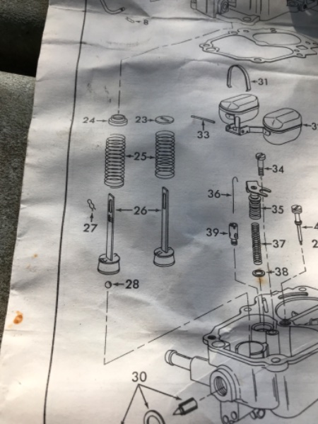

Rebuilding a BBS, I notice a version of the accelerator pump I hadn’t seen. There’s a clip halfway up the pump rod and the slotted washer is under it with the spring below that. Looking at an exploded view of the BBS it looks like this is a variation which I’m guessing is intended to limit the pump shot. Is that right? If so I think I should be able to install it the way I’m used to with no clip and the slotted disc on the rod above the bowl.
If there’s one thing I’ve learned from rebuilding carbs though, it’s never assume that the previous owner knew what they were doing and assembled it correctly. In this case i suspect the diagram is not a clear guide either. Or am I wrong?
