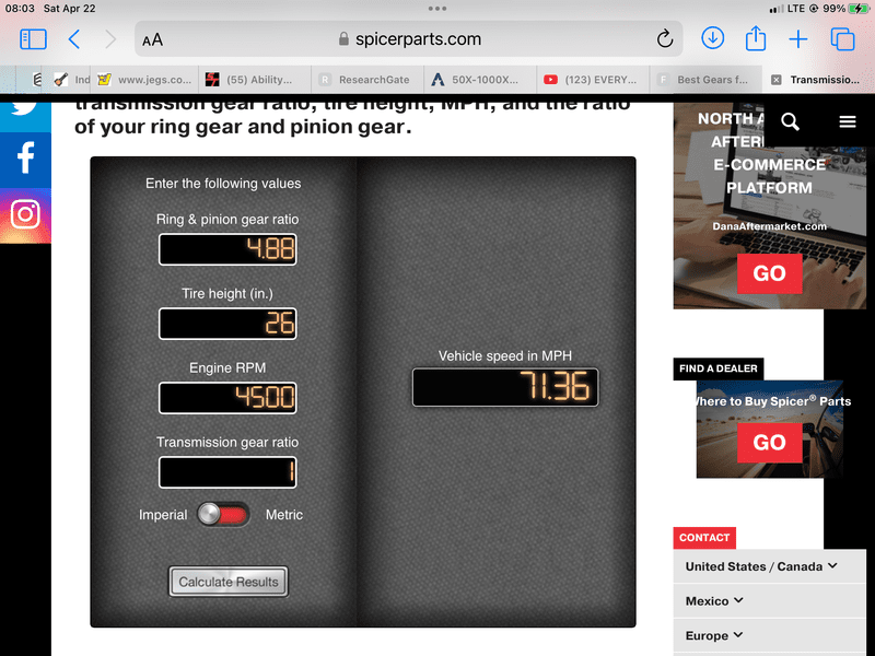

Well I'm late to this party but in the interest of more info, here's the gear/speed/trans calculator I use. I like it a lot, as it's easy to change things up and see what that gets you. It comes preset with lots of stuff but you can manually enter any value you want and it still works.
Speed/Tire/RPM calculator

I calculate the 3.23 gears will drop the highway RPM to about 2700. I would consider an overdrive transmission. With that 440 torque is not a problem to maintain your speed. I would be looking for cruise RPM of 1800 to 2200 for fuel economy, noise and wear.
