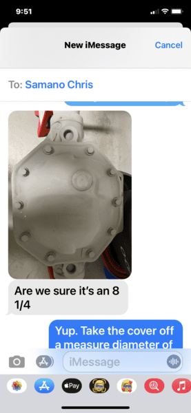

No I really don’t. I think it’s a 80’s Mirada, Aspen. Or Fifth ave.
Thanks, that explains why I have never seen a "C" clip 7 1/4. Never tore down a 7 1/4 that new. Only '60's and '70's. Though I have a couple rears from F,M,J bodies, here. Never even looked close enough to see if 7 1/4 or 8 1/4
Once you know the difference they are easy to tell apart. 8 1/4 rear cover is completely oval. The C clip 7 1/4 has 10 bolts but both ends are straight.
Here is a picture of the rear cover.
This was when me and friend were trying to figure out what the hell it was. I took it out of a 72 Duster. But it had a spool K member with disc. I don’t know if it was originally in a A body or not.
