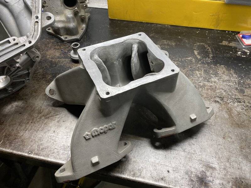

…..and if anyone is in search of a project this is up for grabs :)
What are the specs on that intake?
It’s a mopar 598 intake. Top was cut 1/8” and plunge cut for a 4500 carb. I made spacers for it to fit on my 9.2 deck R3. It was originally on my 9.0 deck R3.
