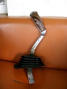

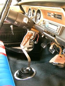

Here is the non Console one I made for my '72 Dart from a cut B Body non Console Shifter Handle:
Shown in Neutral
For the Floor Boot I used a standard A Body Shifter Boot, Heated it up with a Heat Gun -CAREFULLY!- and while warm put the Pistol Grip Handle through the hole..
As for the Console Boot try a Stock B Body Pistol Grip Handle Boot and form to fit your Console Top Studs.
Hope this helped!

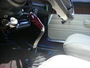

I have a B-body pistol grip shifter in my 73 Dart Sport 340 A-body,no nuckle smashing on the ashtray.I just need to get a oval boot with the square top(69-70)Here,s a link,scroll down about 3/4 of the page.http://www.jimsautoparts.com/shifter_parts.htm
The handle is real cherry wood.8)
P.S I had to drill a second hole at the bottom of the shifter to mount
