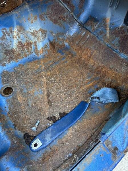

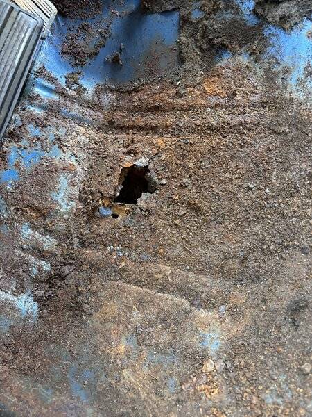

Poke around in the duster today. Found the original order sheet from 71, a copy of original title and the dealer punch card. Found the registration from 2017, so it’s been parked est. 6 or 7 years in the woods collecting water. It has been in the family the entire time. The odometer shows 14,000 and change, who knows if that’s correct. This is really exciting, I hope when I pull the back seat i find the build sheet. Had this car been stored properly when they stopped driving it would be in near perfect shape. I pulled half the carpet out today, found some rust through only the drivers side. Passenger side is solid. The trunk has all the original pieces jack, tire iron, spare etc. in ok shape no rust through.

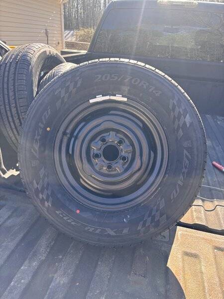

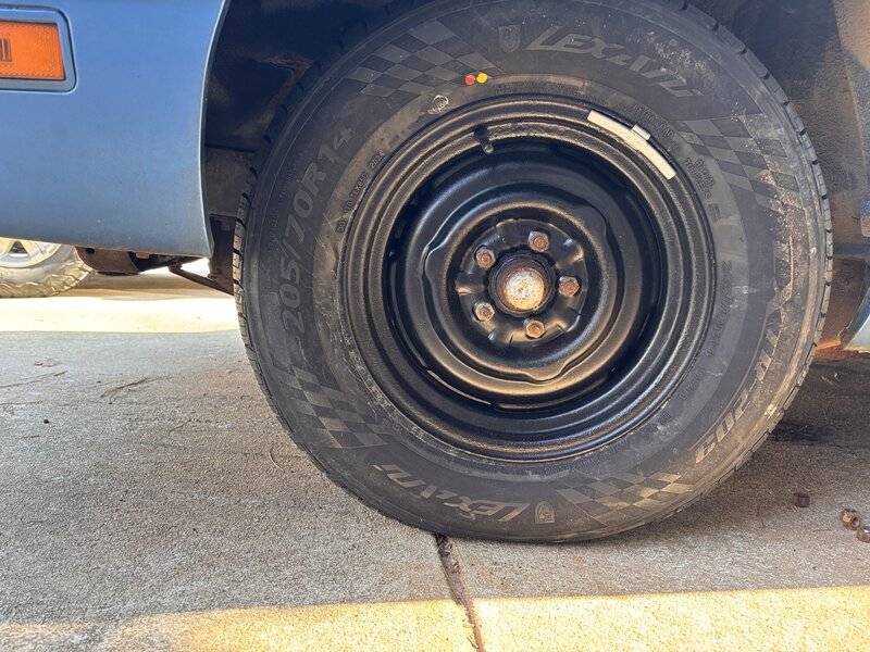

Was able to get the tires mounted today. They’re cheap tires and took some lead to balance them out. I wire wheeled the rims and rattle canned them black.
Princess Valiant mentioned comparing tire sizes earlier. I had 195’s on there and felt like they were pizza cutters.
Had a 215 on a spare, which had a lot of sidewall bulge.
Settled on the 205’s for the price. They have some bulge, but not terrible like the 215’s. I like a wider tire anyway. Also, they have plenty clearance on the front fenders.

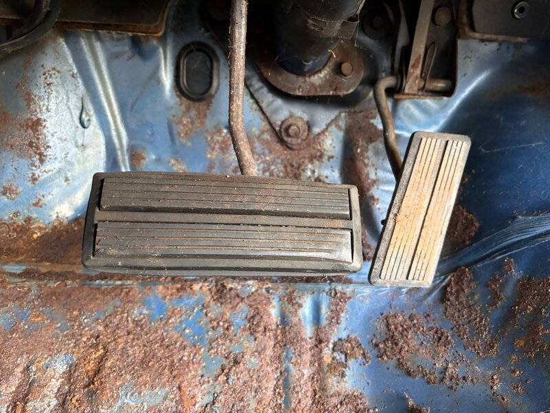

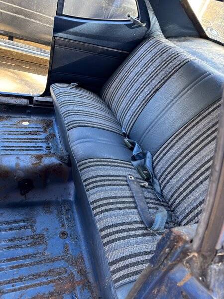

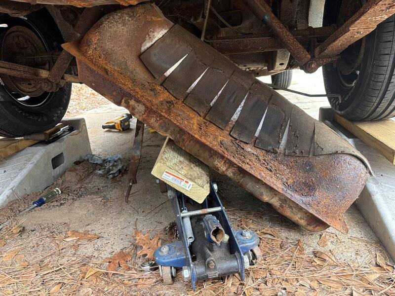

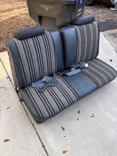

Quick update: I dropped the tank, had bad rust on the top. I got about 7 gallons of varnish gas out of it. Damn **** smells worse than diff fluid. I cut off the bad muffler as well. Old battery from 2012’ would not take a charge and the battery tray was also rotted out. Replacing all of it. Got all the carpet out, looks like the floor boards are not all that bad, I’ll have to patch the drivers sides with a small piece. I’ll wire wheel the rust, treat it with ospho and use some of that POR15 on it. I dig the drug rug seats they’re in nice shape. Judging by the brake pedal not many miles on this one. what yeah think has the odometer turned over?
Quick update: I dropped the tank, had bad rust on the top. I got about 7 gallons of varnish gas out of it. Damn **** smells worse than diff fluid. I cut off the bad muffler as well. Old battery from 2012’ would not take a charge and the battery tray was also rotted out. Replacing all of it. Got all the carpet out, looks like the floor boards are not all that bad, I’ll have to patch the drivers sides with a small piece. I’ll wire wheel the rust, treat it with ospho and use some of that POR15 on it. I dig the drug rug seats they’re in nice shape. Judging by the brake pedal not many miles on this one. what yeah think has the odometer turned over? View attachment 1716344359View attachment 1716344349View attachment 1716344347View attachment 1716344348View attachment 1716344343View attachment 1716344351View attachment 1716344352
Judging from the brake pedal, that just might be 14K original miles.
Sure looks low miles, but I have over the decades replaced pedals with NOS or repops on cars it did nut and bolt restos on, that were even back then, worth some bucks, decades ago.
Be happy and call it a good score, regardless of what the mileage is!
