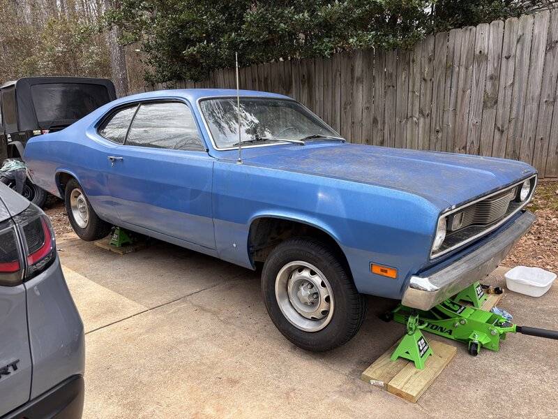

Brought home a 71 Duster

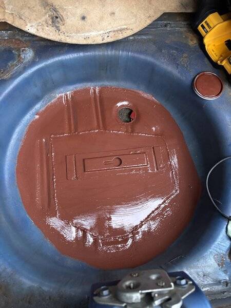

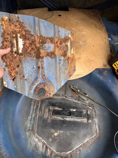

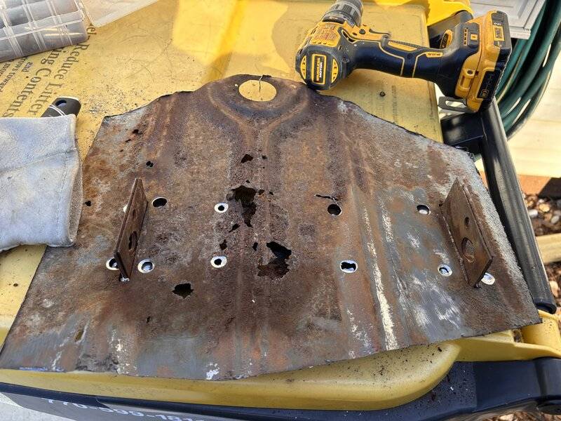

Made some progress on the duster today have a new gas tank that needs to go in but before that can happen. I had to take care of some rust/rot in the trunk. Glad I saved my old grill sheet metal for this repurpose. It’s good enough for me, waiting on a tube of seem sealer from Amazon before I finish it up. I have some blue rattle can I might hit it with after the seem sealer or I may just use black rustoleum.

If you don't want to waste time on spot welds and you are throwing one side away. Bust out a grinder with a flap wheel or stone to take out the spots on your throw away piece. In this case, grind the trunk well piece to get your tire hold down/tank strap mount out.

Dang man no, I’m tired of not having any of my stuff running. I got the seem sealer and a coat of paint on there today. I’m going to blow the gas line out with my air compressor this week then I’ll be ready, but I still need to bleed the breaks. It never ends. I hope it was a good showing.

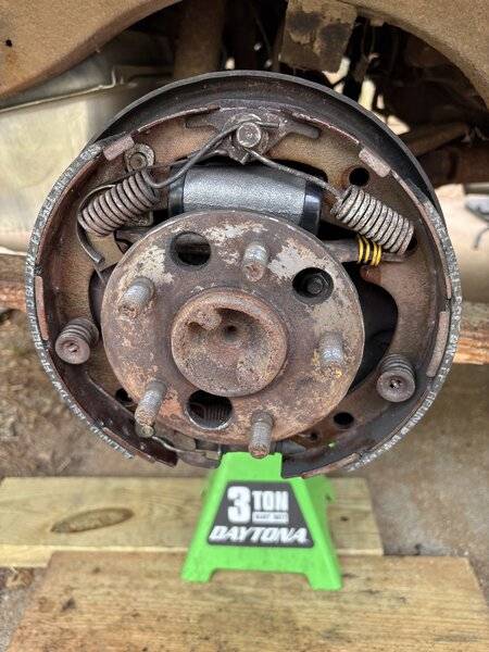

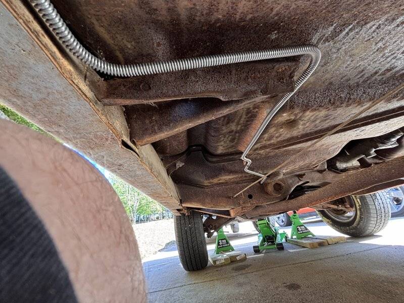

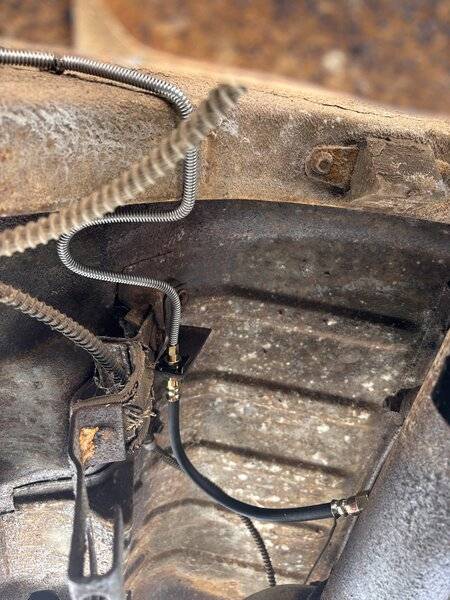

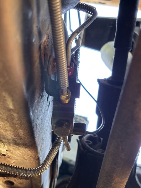

Duster update: you guys convinced me to replace the brake lines. Went with the in-tube kit. Installed with minimal frustration. 2 of the 3 original soft hoses were clogged up and all 4 brake cylinders were frozen. I managed to save the 2 front cylinders with a quick hone, had to replace both rears. Just need to finish bleeding now.

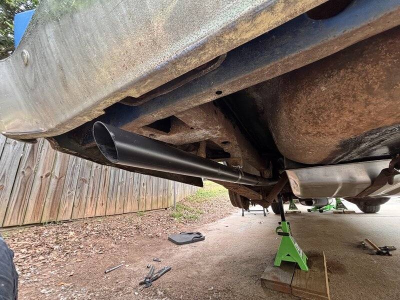

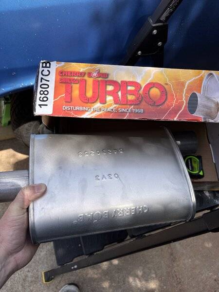

I made up an exhaust with a cherry bomb turbo muffler, hit the tailpipe with high temp black after welding up the pipes. Installed my new OEM chrome gas cap bought from @Jim Kueneman trashed the cracked pitted lockable one.

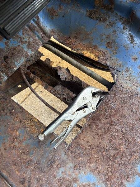

My dumb *** made a mistake cutting the drivers floor board out. I managed to nick the damn speedo cable now it’s bleeding trans fluid a bit, two steps forward one step back.

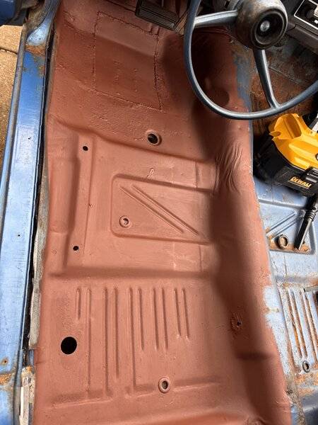

Still need to patch the drive side floor board and buy some new carpet.

Patched up the drivers side floor board. Should have bought a whole new patch panel. But still had some old sheet metal left over from a charbroil grill. So I got after it cutting & welding. Nothing is perfect but it’s functional for now. I’ll move on to the passenger side that needs a small piece patched. Also bought a new blue ACC carpet.

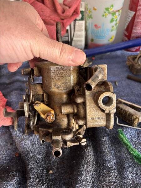

I’m rebuilding the 1920 Holley, it was never going to run decent with the blown diaphragm. I also got the new ACC blue carpet installed. It’s coming along slowly.
First start in years, I put fogging oil in all the cylinders the day before so it’s killing mosquitoes it will burn off and clean up I hope. It’s missing a little bit but rev’s right up when I hit the throttle. I added a little attitude with the sharktooth grille today as well thanks to Mike (Bballfan1). I had to shut it down to get ready for some bad weather.
Cherry bomb muffler is nice and mild with the smoke clearing up. Moving forward with this duster. Has an exhaust manifold leak with also a exhaust pipe leak. I’ll fix that later I need to drop this off the jack stands tomorrow and take it for a ride.
