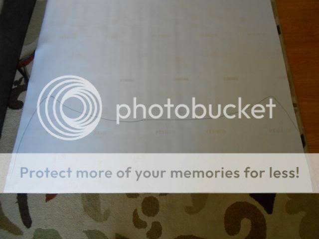

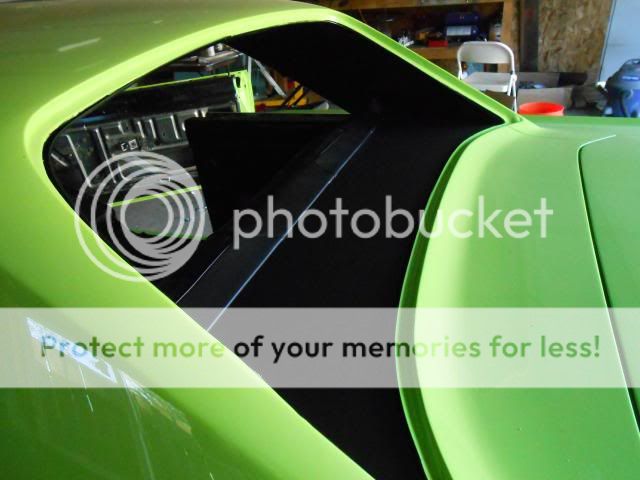

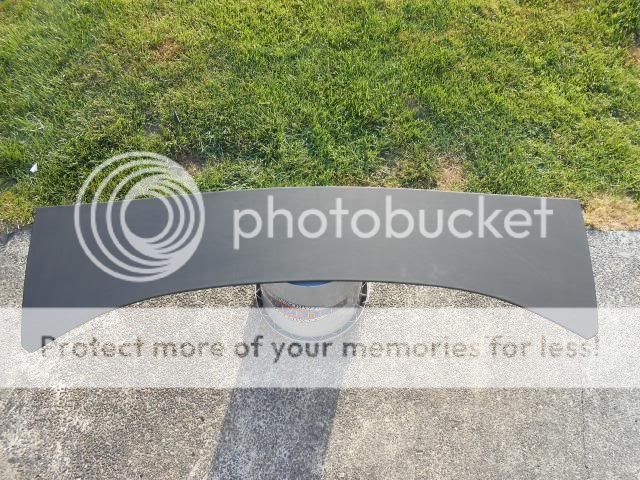

i needed a package tray for my dart. the old one is hammered. used some 1/8" hard board and made a new base then used 3m super 77 spray adhesive and glued some vinyl that matches the back seat pretty close. all done i have $26 into it and it looks pretty darn good if i do say so myself.
im not awesome. just cheap. lol new ones are like 60 bucks then you gotta pay to ship them.

The sun will eat up anything there that isn't UV stable. Years ago I used carpet to cover the shelf in our first notch back. Wasn't long before the fibers were flying in the wind.
the vinyl should do ok in the sun. its furniture grade vinyl. if it gets screwed up them im out $26.

yg 2.0....it looks great and I might end up doing that...with the 1/8" board and material, how much height is left in the opening?...kind of a connected question....to get the seat back out, does it release bottom out first or top out first or some other way? I have a 73 2dr Dart and am just learning about the car... once again, nice job!!!!!! Greg
