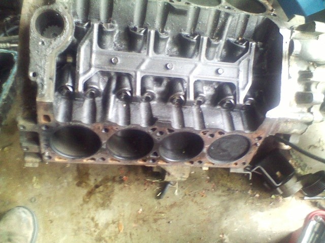

I would be extra cautious, as just cause he says its a 360 it might in fact be a 318, check the block for the casting numbers or have him send pics of them, why waste your time.
There are differences between the Magnum and 360 that you should know about before you buy.

Like Oldmanrick said make sure it isn't very rusty. Rust pitting can cause major issues. Also make sure it doesn't have an excessive ring ridge as the newer blocks don't like to be bored more than .040 max. Mileage will generally dictate how much cylinder wear there is. I usually pass on blocks with more than 150,000 miles but that's JMO. Look it over for any cracks, especially on the deck surface and in the lifter valley. Also remember that since it's a magnum block you won't be able to run older LA heads because magnum's oil the rocker arms through the pushrods while older LA's oil through the block, which the magnum doesn't have the provision for. I didn't see you mention heads but just so you know magnum heads were very prone to cracking. Aftermarket is the way to go for magnum heads. With RHS and Engine Quest making them now at decent prices it's no big deal.
Did you ask him why it is torn down? Generally a good running engine won't be taken apart. The big problem I see here is a totally disassembled high mileage engine and you said you don't have much experience with engines. What are your plans?

He said "the bottom end had a tap and found another 360 for cheap, took off the heads and sold 'em separately because they were new"

Hummm... A tap may something fairly simple or something major. With that many miles on it and him saying it was making noise I'd say it needs a complete rebuild. $100 is cheap enough so if your game to learn it'd be a good start. The book Poisondart recommended is decent. If you can get your hands on a factory service manual that covers magnum engines that'll help too.

Also, miles don't mean much on these engines, they can go 300k on the block with negligible bore wear. So unless something is wrong, you shouldn't need machine work. Do take it apart and check it out though. Chuck a rebuild kit from northernautoparts.com such as this one:

Thanks to everyone for all the advice and input. I went ahead and got it. The guy ended up having a cherry picker, so it wasn't too much trouble. Just gotta wait til my Dad comes home this weekend to get it outta my Jeep.
What do the casting numbers on the side mean?
