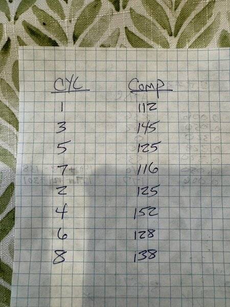

I found this to be odd from the get-go. With the low CR and long, retarded cam, how could I get 152 psi?
