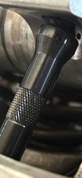

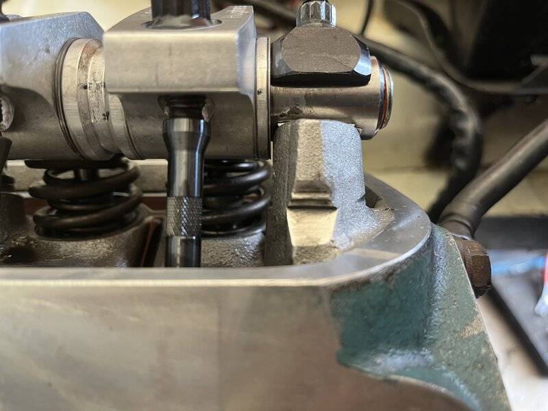

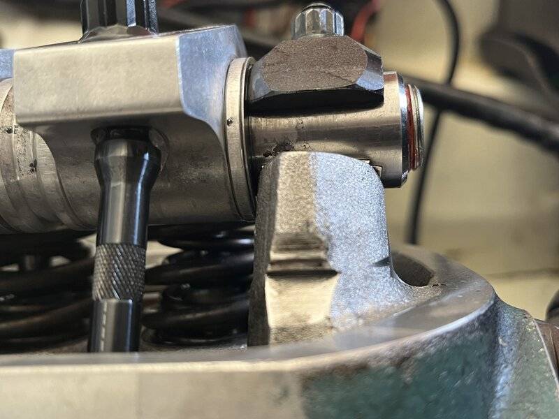

Found another tool I forgot I had, pushrod length checker! I set it for 7.500’’ then to 7.650’’. To me, the longer setting looks better, however I can get a 7.500’’ without going to a custom made rod.
I could get away with the 7.500’’, about 3-4 threads showing. 7.650’’ may be better but 2.5 times the price for rods. What do you guys think??
I don’t think the 7.5 looks that bad but not easy to tell from the pic how much room there is through the sweep on both of them. Longer one looks like the cup could be close to touching on the shaft side?
The photos not that great I know, the 7.650’’ may be slightly long. There is some clearance around the adjuster.
I might just go for the 7.500’’ rod.
A .150 difference is too much. Looks to me like a 7.600 is what you want.
If you want to do it how Chrysler says, set the adjuster at 9/32 protrusion and make the pushrods that length minus valve lash.
That is the correct way to do it.
