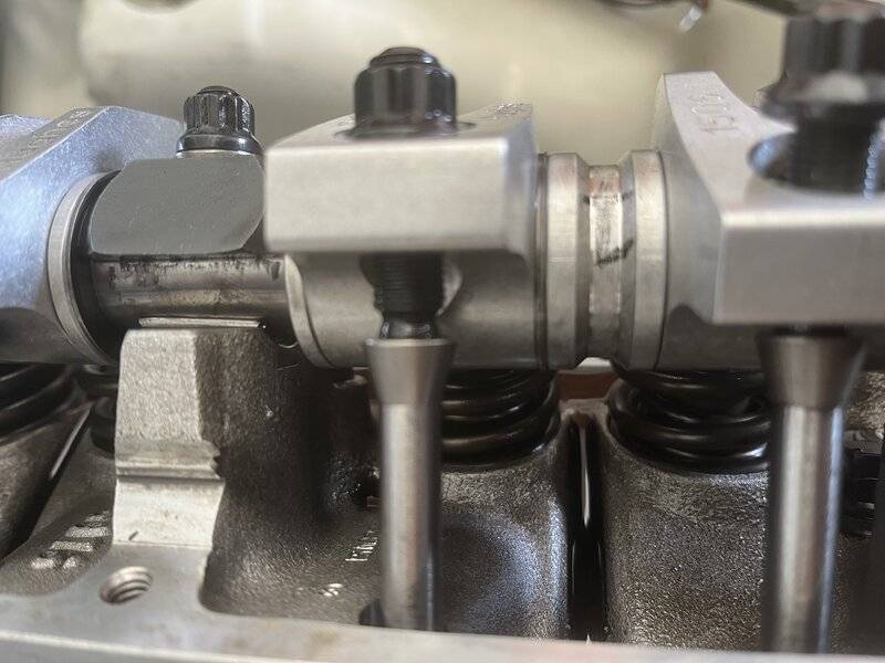

Yeah, it doesn’t look great after the lifter adjustment. I haven’t measured yet, looks like they could be 1/4’’ longer.
I think you should call Rhoads and get their opinion. With that many threads showing, it appears the lifters are staying collapsed some. If that's the case, and you adjust the rockers with the lifters collapsed, when they pump up, bad things are gonna happen.
The lifter has to be bottomed out initially to make the adjustment with the feeler gauge under the roller.
Then open the valve slightly with the adjuster. Back off until the feeler gauge slides. The install notes say that the lifter should be down in the shell after the adjustment.
If this pic is showing where the adjuster screws were(right), to where they are with the correct lifter preload(left), then they were waaay off.
That change should result in a noticeable difference in running duration, and will probably show up on a cranking pressure test too.
I doubt that pic shows a before and after between those two rockers. Likely one is adjusted (left) and one is not yet adjusted (right).
