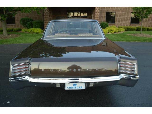

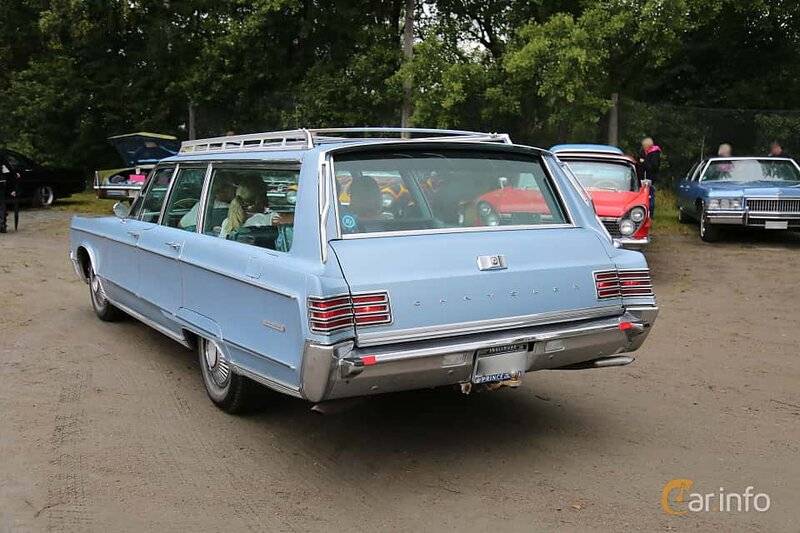

Based on the 67, that’s likely the year that the mold was built.

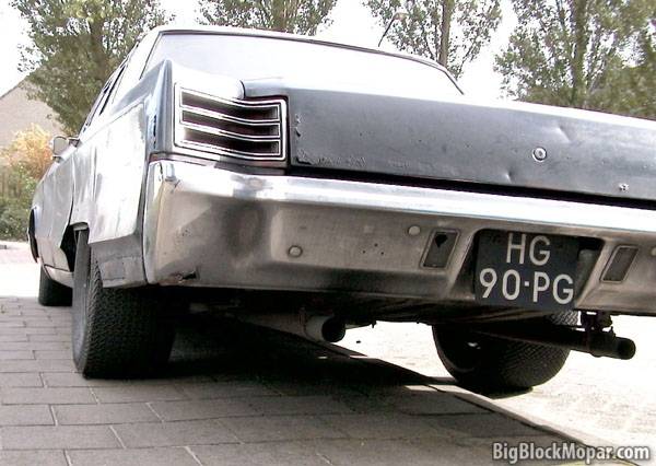

they look a lot like 66-67 charger but the pattern is wrong
They look like '67 backup lenses for Belvedere, GTX, etc??? ***EDIT*** nope, curvatures not there.
Might be a good candidate for the recycling bin. :(
The design is a bit different. The center part is raised for perhaps a bezel. and you can't see the SAE R 67 L lettering. Plus the numbers are different. I'm not going to worry about it. Just recycle them. No big deal.

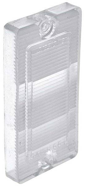

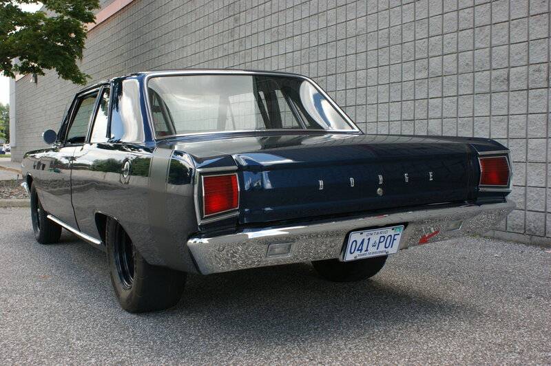

This is what Classic Industry sells for the 67 Dart. Those grooves are vertical while the ones that I have are horizontal.
They are flat. They measure 4 11/16" wide and 1 7/8" tall.
The R means reverse. The L means Dart. 67 is the first year the lens was used, if multiple years. 65 and 67 Belvedere use the same park lamp lens and all the 67’s have 65 on the lenses.
go look at a reverse lens and see what is molded into it. They have an R before the year then a letter for the car line. Look at all the lenses you own and read the codes it all makes sense.
L Dart
