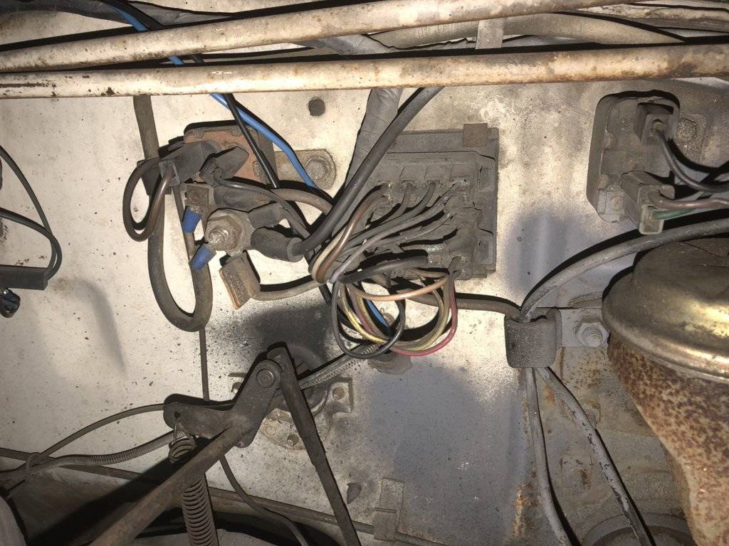

Hey guys. So today was driving my 65 dart home from work. Doing about 75 on freeway. I have the slant 6 225 and everything is stock besides Petronius ignition. No radio. All stock gauges work. Well, the ammeter was reading off the scale in the positive direction and when I hit the off ramp, smoke was coming from the dash!
I shut if off and felt the wire and it was hot. I also grabbed a picture. The red wire is intact but the insulation is burned and where the connector is is black too. I just bought the car last month. The ammeter gauge is extremely sensitive and I’m not sure why. It does have a remanufactured alternator but I do know how many amps. It has a green wire and black wire going to it. Can you guys point me in the right direction on what’s going on here and how to fix it?
Also, I need to drive the car to work tomorrow, is there a way to safely work around this?
It got hot. From the terminal “fretting” another word for micro-arcing.
Carefully remove the wire, and clean terminal, then remove black wire and bolt the 2 together on the better of the two posts. Then go get a VOLTMETER as it will indicate more than just one problem without causing a problem like this and every other ammeter.
You`ll have to bypass the ammeter but yet power your switch and fuse block.
download a schematic or look in service manual if you have one.

That hot wire is grounding on the gauge cluster. there are supposed to be insulator grommets separating the wire from the steel cluster. all I see is disintegrated grommets.The gauge is also likely toast.
So if put the two wires together on the better of the two posts, then it can be driven and the charges system will still be working fine? No more concern for fire?
I did that to my power wagon 20 years ago. If groundi/shorting is a concern, bolt them together and tape them up so they are well insulated. Then secure so they wont short on any other metal bits. And add a voltmeter.
Is adding a voltmeter necessary or is it fine to put both wires on one post and call it a day
Just call it a day. Voltmeter whenever you see fit.
NO.
Something is drawing current through the charge circuit toward the battery.
The question is what?
If its the battery, then if all the connections are OK, you can drive it at low rpms or for a short while at higher rpms. This is the problem with bypassing the ammeter - you won't be able to monitor the current. A few minutes at 20 or 30 amps will be OK if all of the connections and wires are good. More than a few minutes and the battery acid will start to cook and will reduce its capacity to take a charge. Also, the wires will start to get warm running that much current for an extended period of time. Your car may have a fusible link, I forget the first year it was used. If your lucky, it will melt before the others do.
If its not the battery - then there is a short of some sort between the ammeter and the battery. This will be trouble with a capital T.

If the insulating washers are really missing from the posts, then don't attach to the posts. It will still ground out!
Thank you for that I explanation. I need to somehow conjure up a plan of attack now. If something is actually wrong I don’t want to just put the two wires on one post

The alternator post doesn't look nearly as terrible as the battery (red wire) side. Hope it works out.
If you can charge up the battery tonight on a charger - that would minimize the load on those wires tomorrow.

For the shorts with an ohmeter, disconnect the battery posative and then measure resistance to ground from each exposed connection. Should be infinate resistance.
Resistance in the wires will be hard to measure with the ohmeter. But as a precaution, after reconnecting the circuit wires (lets say on one post), then measure resistance between the alternator's bat post and the Battery's positive clamp. If its measureable, then there's still a really bad connection in the circuit. Also check again for ground short. If none, then reattach to the battery.
With the battery connected, check voltage at a few locations. With nothing running, voltage should be the same everywhere. Only when power is being drawn should you be able to measure voltage drops.
One last thought - some one else may have help on this. Where is the pertronix getting power? How much current does it draw? If its drawing power from battery side of the ammeter, and for some reason its drawing a lot of current, that could be another reason the the ammeter indicated charging.
Bottom line. If the battery was low, and there's no shorts, the poor corroded connection was the culprit.
I'd then Charge the battery. Clean the ring terminals - join together and check that the circuit for resistance. If OK proceed. Check the voltage before starting, and after starting at both the alternator an the battery. Put the multi-meter on the floor behind the front seat. Probably have a hand extinguisher in the car too. (hey you asked, and I do bring one when I've having problems that could light up)

The weak link is the connections. But the point is if there is a short or another bad connection - that's how a fire is going to get started. Without the ammeter to monitor the current flow, he needs to check these possibilities out before driving it. That ammeter's bat post is no condition to be used as is - and I'm not suggesting he use it tommorrow. In fact I'm suggesting he may not want to use the other one either. Depends on whether it is insulated from ground.

The movement in your video is telling us current is flowing from the alternator toward the battery. Specifically, the flow increases from near zero to 20 amps when we hear the engine rev. That's not intermittent per se, its responding to flow.
To know why, will require some more testing or more info from your observations.
We know some things to start with.
The current only flows when something calls for it.
Alternator potential output increases with rpm.
Something on the battery side of the ammeter was calling for power - maybe the battery, maybe the pertronix if it was attached to that side, maybe a short.
The alternator doesn't have enough power output at idle to satisfy that demand, but as rpm increases, its output increases and the demand is met.
Its worth checking the battery condition because many times the stock alternators could barely provide enough power at idle for the ignition, lights, and wipers or other accessories. Over time, the wires and connections oxidize, and sometimes get loose. This means even less current and voltage to keeps things going at idle, so the battery takes over every time the car is idling. Then when driving, the alternator recharges it. The lower the battery charge is, the more current the ammeter gives it, when it can.
In the above situation, the culprit is low alternator output at idle combined with poor or loose connections.
A similar situation will be if just one of the alternator diodes fails. The alternator still puts out power, but only 2/3 of what it would normally. At idle, this is terrible. If you saw the battery discharging at idle - this may be the problem.
A voltage regulator failure could indirectly cause similar symptoms if the battery was low. If the voltage is high, or goes up with rpm, (another reason to be checking with the voltmeter) the regulator is stuck on full field power. If the battery is low, then once again current will increase with the rpm. But in this case its because the voltage is allowed to climb. Or, I've had this on some of the new solid state ones, where the regular just gets a little flakey.
Another reason for a regulator to full field when it shouldn't is poor connections in its circuit - usually a bad terminal crimp or oxidation at the bulkhead. If the regulator see less the 14.5 ish Volts, its going to let more current through to the alternator's field. The regulator here is just doing its job. If its getting under 14.x volts, it thinks the alternator isn't putting out enough power.
Measure the voltage at the regulator connection.
Last, if the pertronix is wired to the battery, and if its going flakey and now drawing more current than before, this, plus the poor connection be causing what you see.
And going back to the begining - if there is a short - the insulation missing anywhere and a wire touching a ground its going to draw as much power as the alternator can send it.
edit: I'm thinking this is less likely - assuming your battery is still connected. Because if there is still a short in the charging wiring, the battery will discharge through it - and you would have noticed that immediately!
