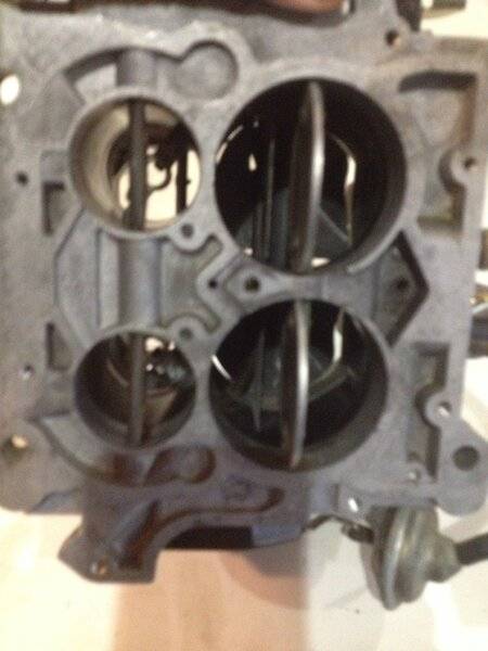

Sorry my brother but this is incorrect. Yes! Even though the primary and secondary throttle plates show a difference in sizes, this is still not considered a spread bore carb.
The TQ & QJ are spread bore carbs. There, the difference is obvious.
Its not a spread bore with a small difference in sizes between the primary and secondary bore but the huge difference between them. See the TQ below.
The industry made this distinction decision long ago.

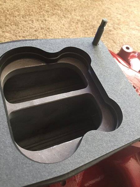

The secondaries are spread out wider than the standard square bore intakes would allow the carb to be bolted onto the intake. They had to spread the secondary bore to meet the more spread out width of the secondaries of the new carbs. The QJ & TQ. Holley also has spreadbore carbs like below in vacuum & mechanical secondary. 4160 & 4150 styles as well as the defunct two piece design now carrying the Summit logo. Those were the 4010 & 4011 series carbs, FWIW. They were good units.

Spread bore. The name comes from the QJ with the huge secondary bores. The c/line of the sec bores had to be 'spread' to make room for the extra large t/blades.
