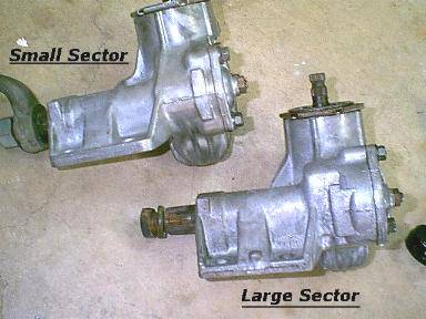

All A/B/E body manual steering boxes had the same diameter sector shaft. The power steering boxes changed from a small to a large sector, but the manual boxes stayed the same.
Only C-body and van manual steering boxes had a different sector diameter.

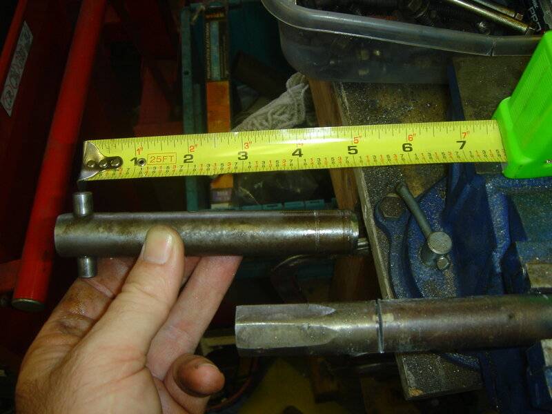

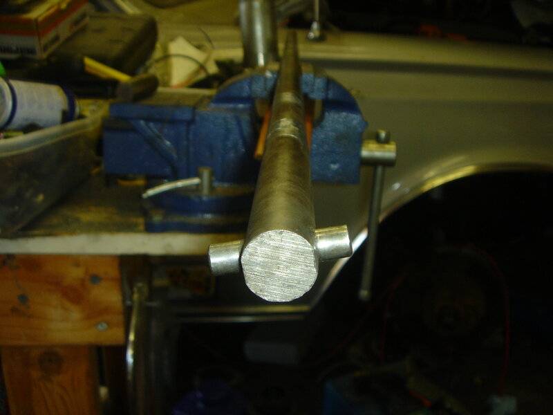

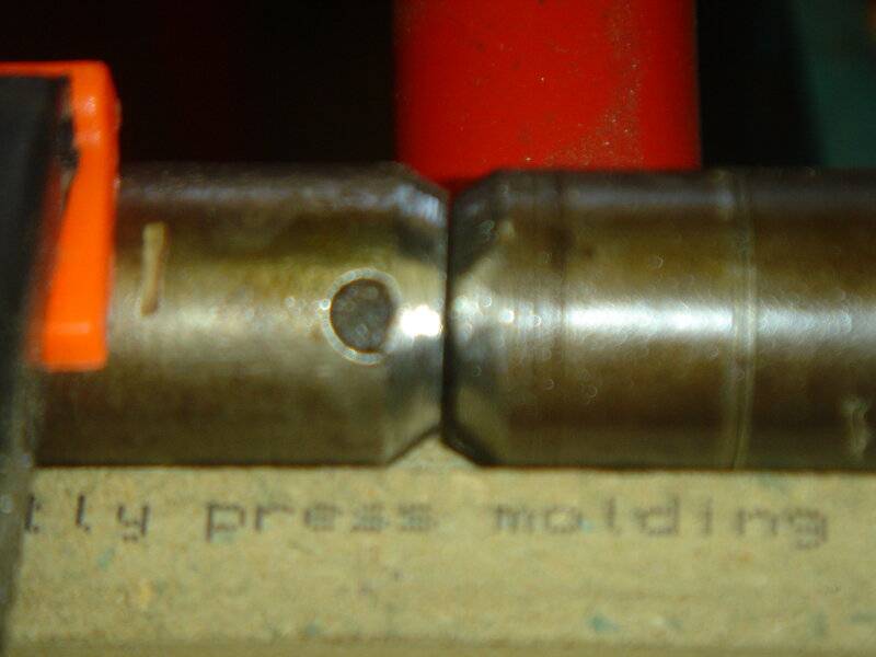

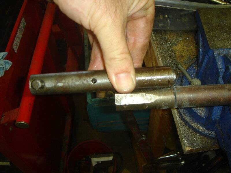

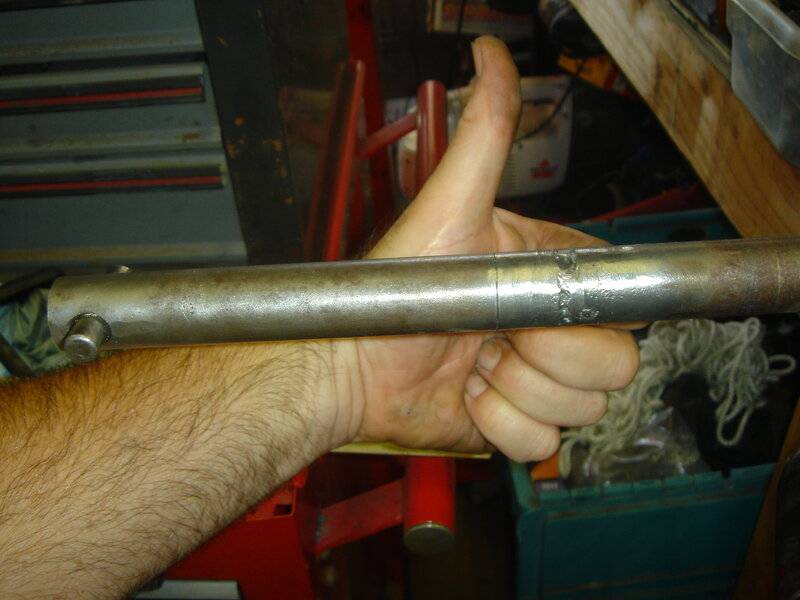

I went cheap a long time ago and cut 6" off a steering shaft from a junkyard car and cut and welded it to my auto column for manual length. Worked like a charm and you dont need t take column apart (I did though). Hot rodding at its rawest form...hot metal!
Up to '72 that is true. From '73 up they all came with the large sector shaft.....just like the power steering gear boxes.
100% false.

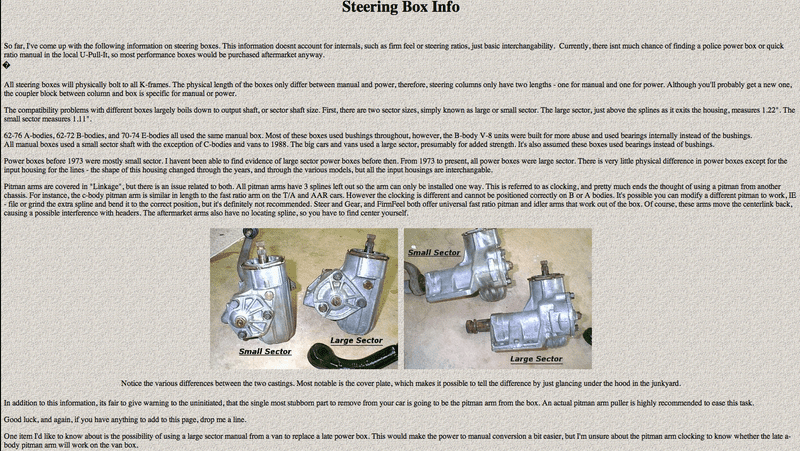

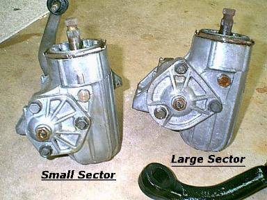

There was only one sector shaft size for the A/B/E body manual steering boxes. Nothing changed in '73 for the manual boxes. Which is why I can run a 73+ manual steering pitman arm on my small sector power steering box with a 73+ center link on my '71 Dart. Otherwise, there would be no way to use a small sector steering box with a 73+ center link.
This is where I would normally link the Big Block Dart tech page with pictures showing exactly that, but they changed software so I may have to work harder to see if I saved that info somewhere. Only C-body and van manual steering boxes ever got a larger sector shaft.
***Edit***
Apparently I was smart enough to screen shot that particular tech page at BBD. It probably won't be very legible once the site shrinks it down, but it says what I already did- all A bodies from 62-76, all B-bodies from 62-72, and all E-bodies from '70-74 all had small sector shaft manual steering boxes (1.11" diameter). The only large sector (1.22") diameter steering boxes were either power steering boxes from 73+ OR manual boxes for C bodies and vans, up to '88. And the difference is easily visible in the casting and the cover plate.
If you can't read first screenshot, send me a PM with your info and I'll email the original, which is larger and legible.
View attachment 1715703378 View attachment 1715703379 View attachment 1715703380 View attachment 1715703381 View attachment 1715703382 View attachment 1715703385
Phishta, old thread but wondered what is the difference in length between manual and power steering? I read 6” cut but was that the difference or the rough cut to make your piece? Great photos by the way. Figure if I have the total length I can fabricate something up.
Aargh, I didn't measure it but the 6" was the rough cut at the junk yard and that was the basis for the cut off of the power shaft I had. I wanna say like ~2" but whom ever has a firm feel adapter could possible measure the bottom of the socket to the splined tip?
The measurements I have written down are 40-5/8" for manual steering and 37.5" for power steering. Obviously the steering shafts are collapsable so it's possible those are off a little bit, I don't remember taking the actual measurements at this point so i won't swear that they're perfect. But the manual to power adaptors are over 3" long, so they should be fairly close.
