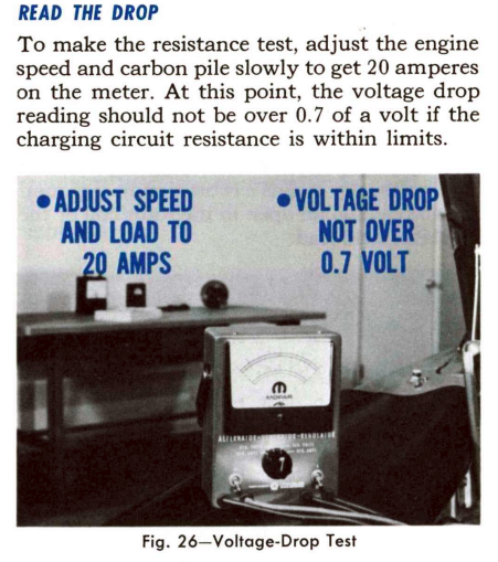

Its important to note this is not voltage at the battery. This a test whether the regulator is doing its job based on the voltage it 'sees'. The voltmeter is connected from the junction at the ballast resistor to ground.
The factory considered up to 0.7 Volt difference from the alternator to the battery acceptable with 20 amps flowing from the alternator and about 15 amps through the dash ammeter to the battery.

Actually a little bit of drop on the charging line is not terrible so long as we are not heating something up. If there is drop on the charge line, the only thing that happens is, that the regulator will read low and ramp up the difference
The single biggest problem with either early or late regulators, aside from the weakness in the ammeter circuit, is that the share the power terminal with the ignition terminal. So far as I know, all OEM GM, other than "one wire," and same with Ford, have a dedicated sense wire. This wire, since it is ONLY used for sense, carries no current, which means it should be able to truly and accurately sense battery voltage.
