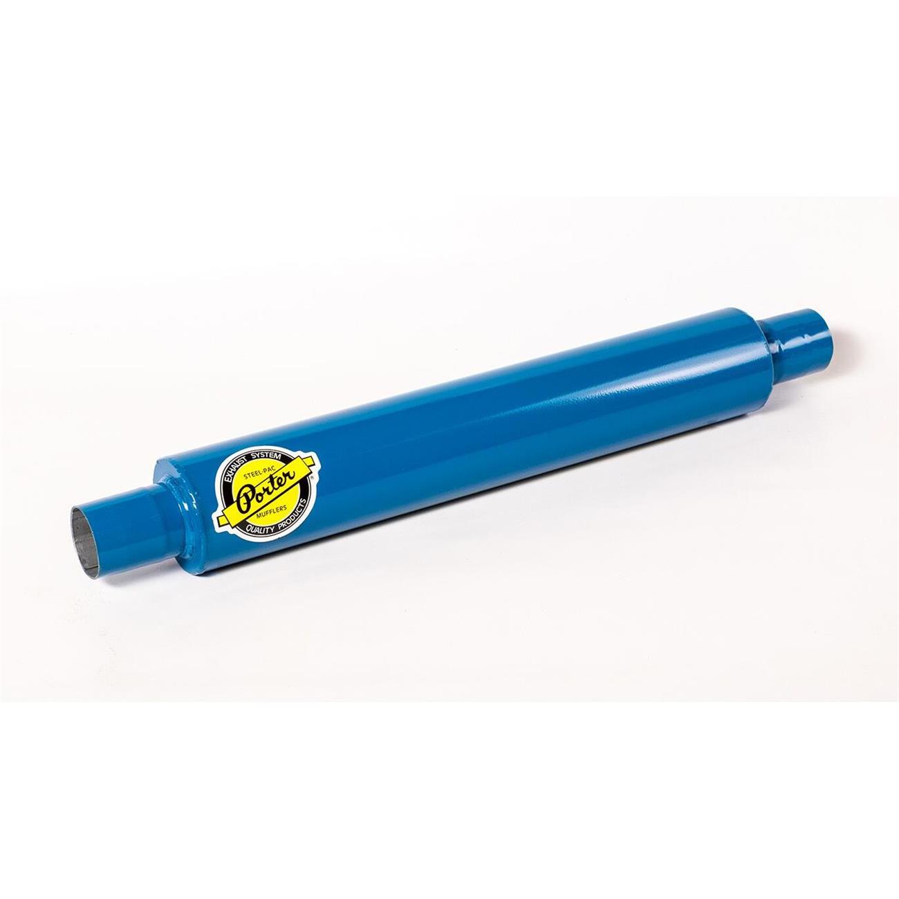

I was never a fan of the raspy sound of glass packs and the older they get, the louder they got. A friend has Porter steel pack mufflers on his Satellite. It does sound good but it has that glass pack cackle. The Porters are packed with stainless steel wool so they don't burn out as soon as fiberglass does.
