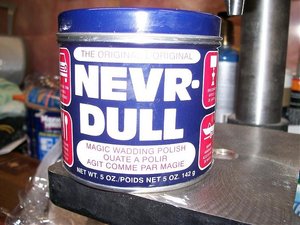

neverdull is good stuff.
Jewlers rouge can be picked up and working in with a buffing wheel on a Dremel tool. Takes time.. but works well.

Good idea RPM,I think there is a good chance to get that mirror finish back that way.
Thank you all.
I will try the suggestions and post the results...this may take a while.
