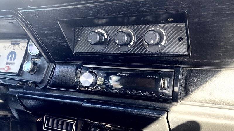

They didn’t have a control panel I was happy with, so I had them just send the knobs and I made a new panel to mount them in.
Worked out pretty good.
