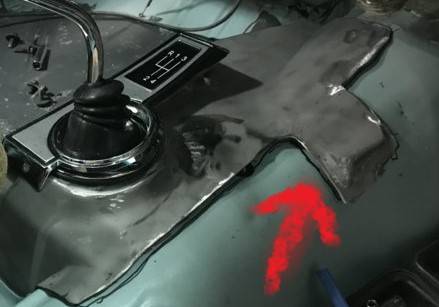

Here is a pic of my cuda I recently cut out for the hump. The factory trimmed the floor and left a strip where the torsion bar crossmember is. Although I fully welded mine, the factory typically only partially welded this strip and it usually had a gap....just floating there.
The second pic you can see the factory just stitch welded these in and then smeared seam sealer over the joint. It does the job just fine, no need to fully weld unless you really wanted to.

Why does this Extra leg exist on the hump?
Is it really necessary to cut that part out of the tunnel?
Same deal on hump on 6-5 B body. Those years were before the A833 and Hurst shifter. They took the T10 and it was bigger, different. I cut that off as I used the A833 on my 64Savoy. I guess it depends on what you are using or if you are anal?:poke:
Not Anal, just didn't know. I'm using an 833 with a Hurst Comp Plus in a '65 Barracuda So, Cut it Off? Cool!
