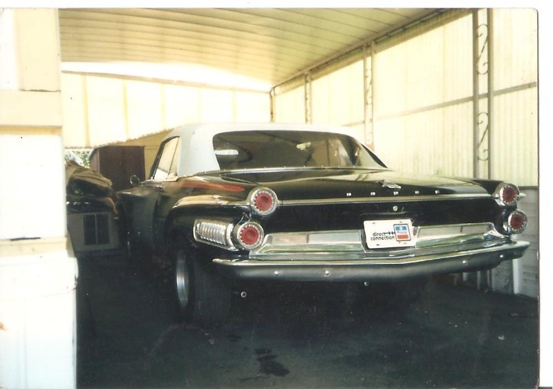

Wow!!! That is a stunning looking car. One car where the convertible version improves the aesthetics.
