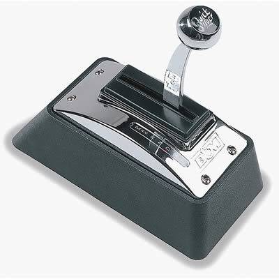

I'm going to convert from column shift in my Duster to floor shift when I put the buckets in next week. I've been looking at the B&M star shifter and the tci fast gate
Any opinions on these? How about other stuff I might be over looking? I don't have Hurst money, and I don't have a console to work with.
The car is just a fun weekend car with a decent 318, it's not a purpose built track machine.

B&M Pro Ratchet. Simple and affordable. Also NHRA compliant since it has a reverse lockout.
I went with star shifter. Cheap. Reverse lockout. Chrome. Fit the bill in my mind. I haven't installed it yet.
My all time favorite is actually the old B&M Kwik Klik.....but it did not have the reverse lockout. They were super cool though.

I should add, the star shifter is nice because it does detent OR ratchet. Wanna shift manual on the street? Detent. Looking to bang gears on the strip? Ratchet. But it does not work with reverse manual valve body setups. It was ideal for my daily driver where I might just cruise in drive, or slap down a gear or two and lay rubber.
