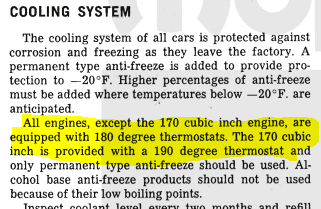

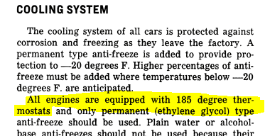

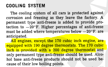

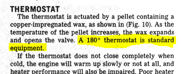

The factory thermostat on all of these A-body cars was a 195*F. Look it up.
New cars are harder to cool anyway. The engine compartments are tighter, the hp per cubic inch numbers are MUCH higher, and that means more heat with less metal to absorb and diffuse it.
[1] And lots of people use 180 [ or 160 ] thermostats in their old cars NOW. When these cars were made, the fuel had lead in it which cooled the combustion process & reduced the chance of detonation. No lead to day, cooler engine by whatever means, to reduce chances of detonation.
[2] New cars have much more alum in them than old cars [ look it up ]. Easier to cool because of it's greater thermal conductivity compared to CI.

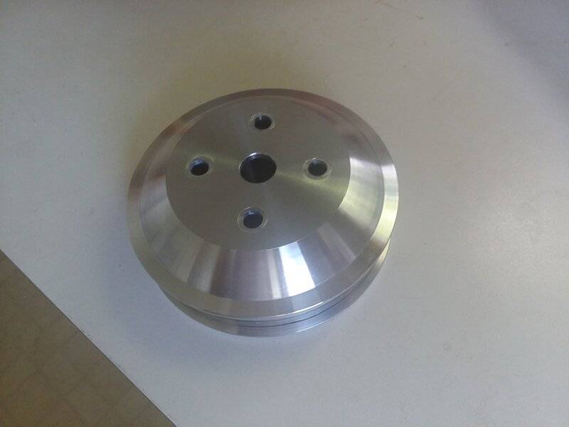

Got a nice job of machining down the aluminum serpentine pulley so the silent run fan would bolt up with the proper spacer.

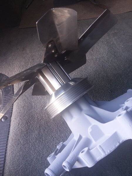

As a mock up example here is the first silent run fan setup:

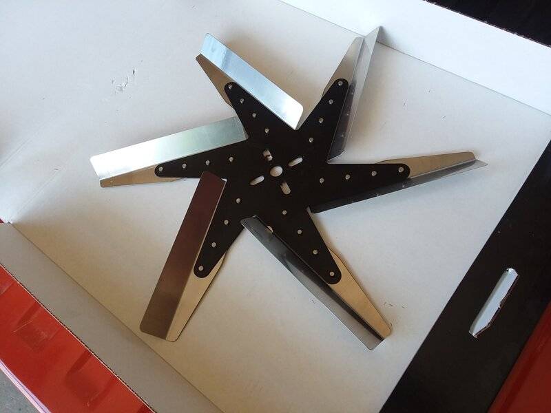

For those who are curious about the the "Flex Fans".
Here is a picture of one that is 18", makes lots of noise, robs power, and won't clear in the tight quarter situations like Elephant Ears, serpentine belt setups/dress ups, and just plain tight quarter layouts.

Third, those thin sheetmetal blades absolutely flex. Maybe they flex less than the more standard flex fan design, but they 100% still flex. That's why they're riveted on. If flex was not part of the design they'd be solid blades instead of a thin blade riveted to a more solid base.

Not quite. Out of curiosity, I looked it up. It seems to vary depending on the year.
Here's what the '66 Dodge FSM says:
'68 Plymouth FSM:
'69 Dodge FSM:
'73 Dodge FSM:
Well you got me. All of my 318 cars had 195's in them, I probably shouldn't have assumed they were factory just because the parts houses list them as the stock replacement. Thanks for pulling that stuff up.
The blades certainly flex...and I wonder what that Chinese fan might do at 7500rpm. (I'd expect nothing good.)
