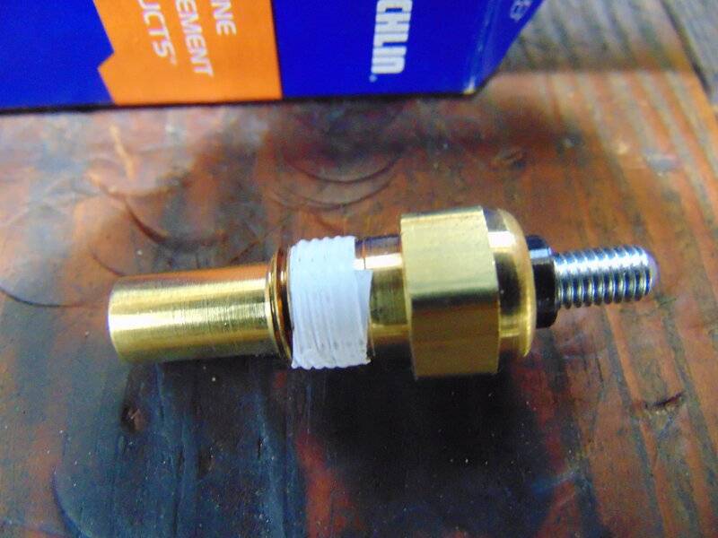

I installed the Echlin temp sending unit from NAPA and the temp gauge works perfectly.
The part# is: ECH TS6178
For those who discussed the advisability of various sealing methods - this unit came already taped from Echlin with sealing tape.

Thank you for this posting, much appreciated! I bought two Standard TS205's (which are listed for the '65 Barracuda 273 on Rock Auto), and neither one worked, the needle hardly even moved at 180 degrees. I did some troubleshooting, hooked up a variable test load on the temp sender circuit and determined that a 20-25 ohm load would put the temp gauge right in the middle. Testing the TS205 in a pan of lightly boiling water only got the resistance down to about 65 ohms. I bought the Echlin TS6178 from Napa, put it in the boiling water and the ohms dropped to 25. Installed it in the engine, started and let it come up to 180 (checked with laser thermometer pointed at base of sensor). The dash gauge reads right in the middle where it should be. Either both TS 205s were faulty, or the parts listing is incorrect for '65 applications.
