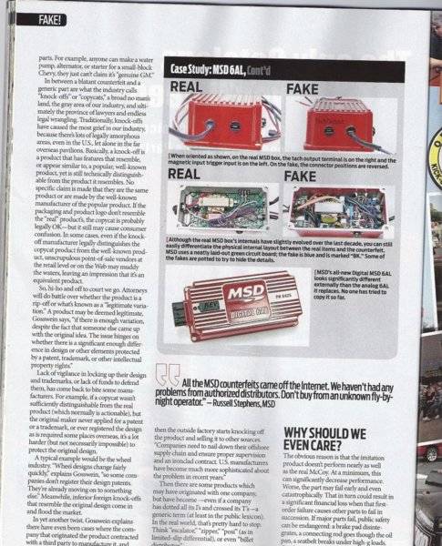

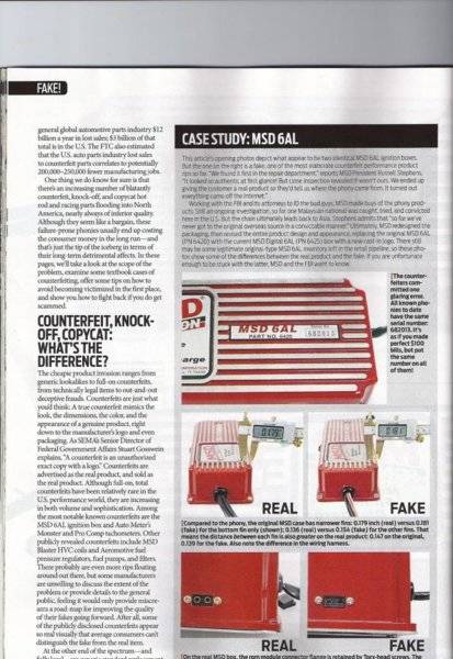

Counterfeit MSD 6AL boxes
Boy o boy these bastards just keep at it don’t they!
They all got the same serial number "......have the same serial number - 682013"
open them and they got a cheap module glued to the case.
All REAL MSD boxes have torx head screws, the counterfeits have phillips.
All REAL MSD boxes heat fins should measure no more then .150", the counterfeits vary and are larger.
All REAL MSD boxes on the end the mag input is on the left and tach output is on the right, the counterfeits are reversed.
and on a personal note, "all REAL MSD boxes will fail on you sooner or later" :icon_fU:

I posted an article about this a while back. Was in Car craft or hot rod magazine. Was more then just msd. Told you how to identify.
