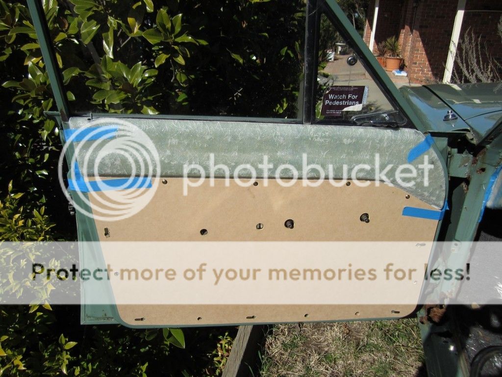

by now some of you will know I don't do stock with my trims.....I'm not a fan of the painted door tops on A bodies so I made full lenght door panels

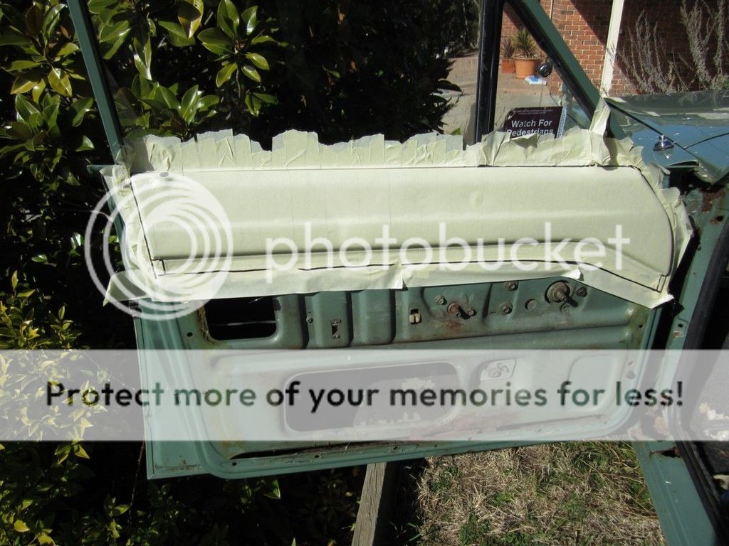

I started by tapeing up the door tops to mould a fibreglass cap
I then bonded it to the panel while inplace on the door

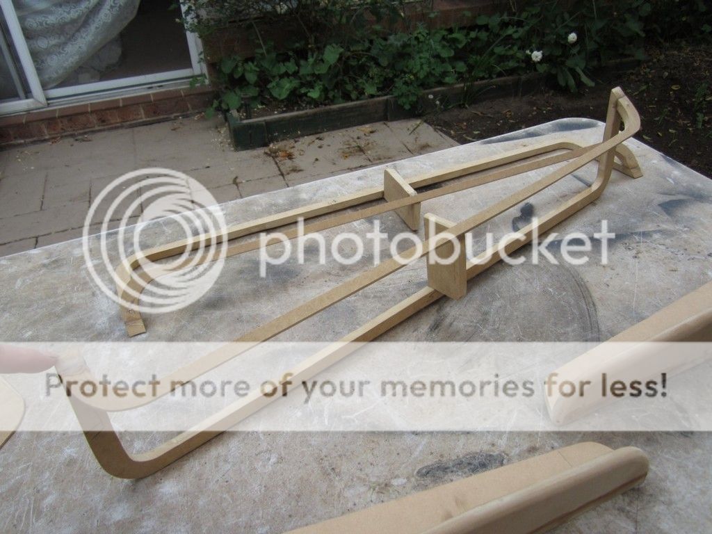

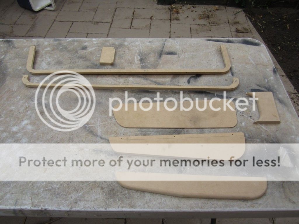

I then started on the armrests and door pockets.....I used 1/2" MDF for the frames

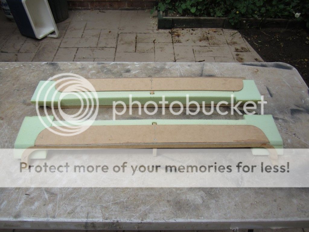

I again used Urethane foam for the sections that are to be shaped
that's about all I have time to post right now so....to be continued!!

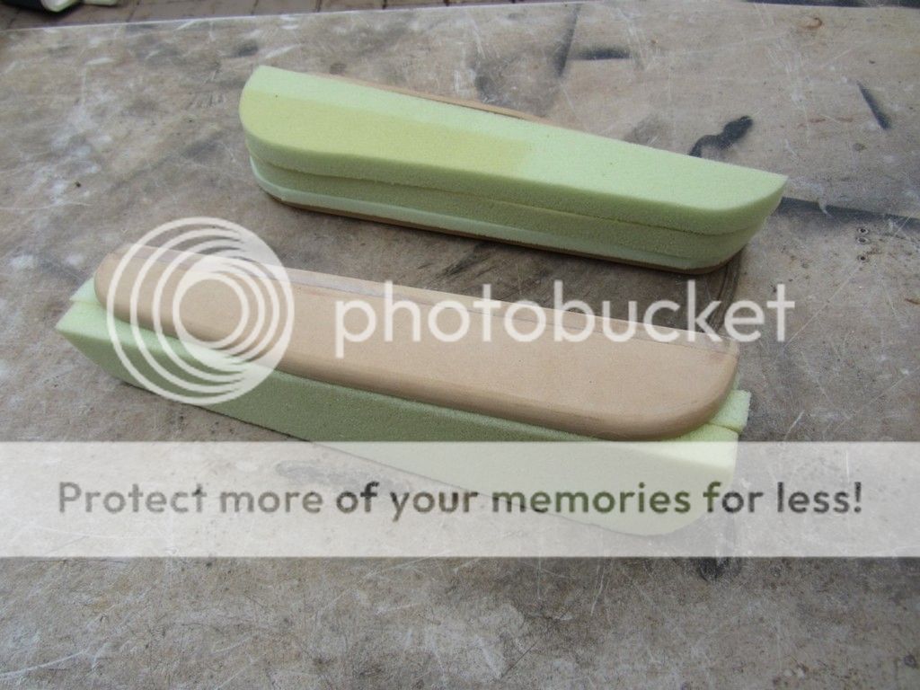

the foam is easy to cut and sand with 80 grit
once fibreglassed I did a test fit
