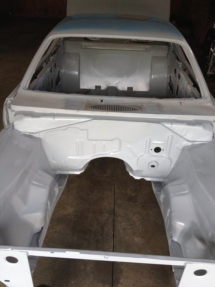

Has anyone modified their firewall INSTEAD of using a 4 to 2 bolt plate to run a 2 bolt master cylinder? I'd love to see pics as I am in the middle of smoothing the firewall and it would be a good time to take care of this at the same time.
Plan is to cut/weld existing studs, drill new holes to wels the 2 new studs in, and make the thru hole smaller if needed.

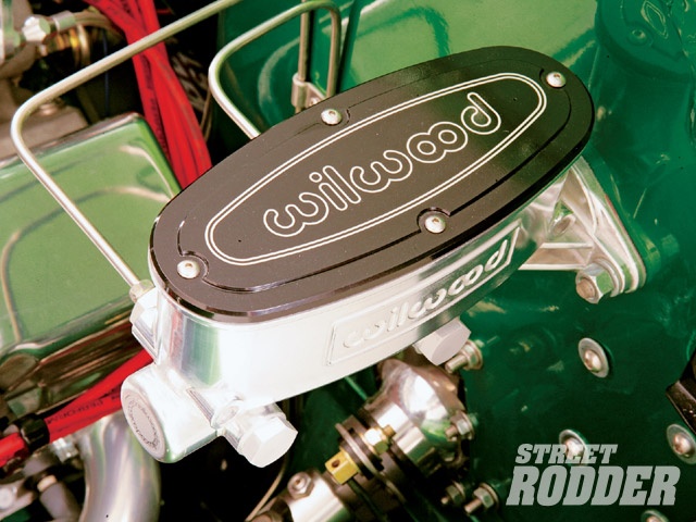

here's a good photo of one converted (although its on a Chevy) you get the idea, Now imagine a nice allen head button bolt showing instead of the nut.
attachment.php
yea..either looks fine to me. if the nut bothers you, use a fancier ARP 12 point. dont sweat the petty things, pet the sweaty things!

Thank you everyone for the input- exactly why I love this forum, you don't just get pats on the back and silence, people speak their minds!
you are right, I am not really saving the $40, but instead of looking like an afterthought of an adapter is on my car, the upgraded part will look like part of the car. Makes it a little more subtle, and a little more streamline.
My is car is completely disassembled, so some of these mods are a little easier to do than say doing so on a daily driver.
