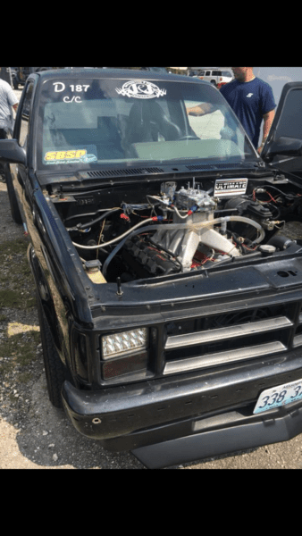

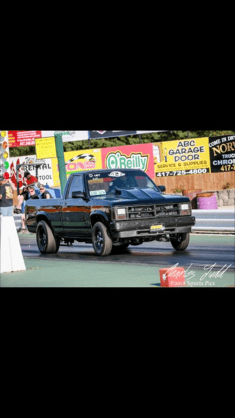

My friend has a 87 Dodge Dakota that has those same wheels. There is nothing wrong with them you just have to use openend Acron stile lug nuts. He has been in the 10.70 in the 1/4 with his and street drives it. Heck I have the same kind you have but mine do not have the painted centers.

sweet dakota. Anymore info on it? you can pm me if you want. (didn't mean to derail the thread)

It's not a derail when it shows/proves these wheels are BAD ARSS enought to install and never look back!!!!!!:thumbsup:

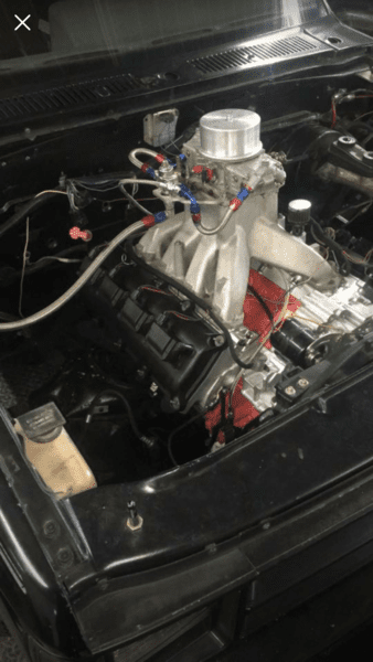

He has a pump gas gen 3 Hemi in it . Ritter intake. I think a 750 DP carb. I would have to ask him again. 727 with trans brake. 4.30 gears and 275/60/15 drag Radial tires. He races in a class claimer class. Which you can only run production block, heads cranks, Rods etc. some body that’s racing in the class can come up and claim your engine for $1500. It’s a class that try’s to make it so every body has a chance to win and have fun. Back to his truck. I don’t remember his cam specks. But he is a member here but I mostly see him on the gen III section.

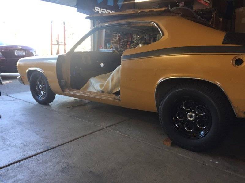

Its SO far from nice. I got the car as part of a deal about 15 years ago. It was my daily driver for about 10 years in the snow, ice and salt...
She started as a full interior 318 904 7.25 granny get down.
In all honesty I should have started with a better car but shes mine and she has never let me down.
Now shes got a 12 point funny car cage, a bad *** 360 built by my buddy's at Gromm Racing and still has never let me down.
Shes ugly, got lots of rust and a paint job that I wish some *** hat had never put on her.
But shes mine and each time i make her quicker all folks wanna know is when you gonna fix the body and paint?
I just may never fix the rust or paint her.
She already won first place in the largest MOPAR show in California going against 100,000 Dolar hemi cars so all the folks who don't like it can go get stuffed..
