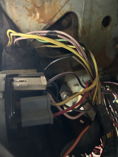

When I turn the lights on I was thinking. I’ll look at my fuse block, just might be the place to plug it in. After all I need to plug in the power wire in there.

I’m going to plug it into the fuse box. Thanks
