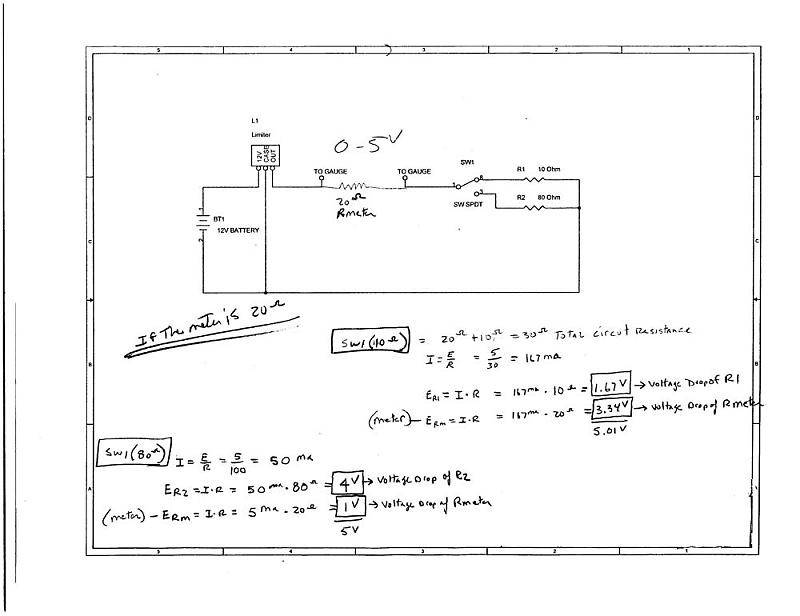

Red Fish, this is what I have on testing gauges out of the car.
This is based on trying to check for half scale and full scale based
on a resistance of 20 ohms.
Seem about right to you?
Hope this helps, gotta run for now.
Holy crap! Did I see the theory of relativity in there somewhere??? Someone is going to have to explain in dumbass terms how to check these gauges.
LOL sorry. I kind of posted that for Red Fish.

The gauges should read 20 Ohms resistance across the legs so you
can check them with your Ohms meter and see what you get.
