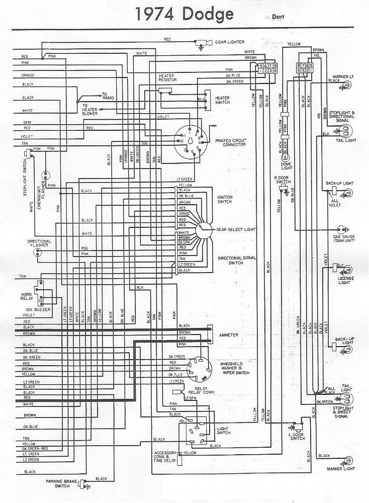

so there are two flashers, one on each side a bit away from it, when you turn the turn signals on you can feel one pulsing, then i turn the turn signals off, turn the hazard lights on and the other one pulses(you can feel this) and this one in the picture...doesnt do anthing...im wondering if its the heater resistor, because the one on my wiring diagram doesnt show what colors go to it
wiring diagrams 74 dart[/ATTACH]
Thank you daliant, That is the one I have right now, It doesnt have all the wiring because of not having some of the features on it like AC and a couple more or some, I really appreciate all the help everyone and im going to try and fix the rest of the problems tomorrow
So on the wiring diagram, as you can see above, the red wire goes to the ash tray, and that always has power of course, but it was plugged into the pink wire(jeririgged it looked like)to give the pink wire power, and I think this was one of the shorts.
We are open for all ideas still, its probably going to take one or two more days to fix

So that little round piece has to be either part of the time delay on your interior lamps, or that seatbelt interlock. Heres an idea.. just unplug it.
I dont know all I'd like to know about how these odd features work since I haven't owned a 74. I do know dome lamp positive wires are yellow and hot wires are pink so I suspect that piece is time delay relay but I cant be sure.

I have been trying to fix up an electrical problem on my car, and according to the 68 barracuda wiring diagrams, that thing could be a time delay relay for your interior lights. If you trace the wires off that on the diagram it goes to the cigarette lighter then plugs into the red wire with connectors taht it looks like you got there, then it goes to the fuse panel at the cigarette light fuse.
